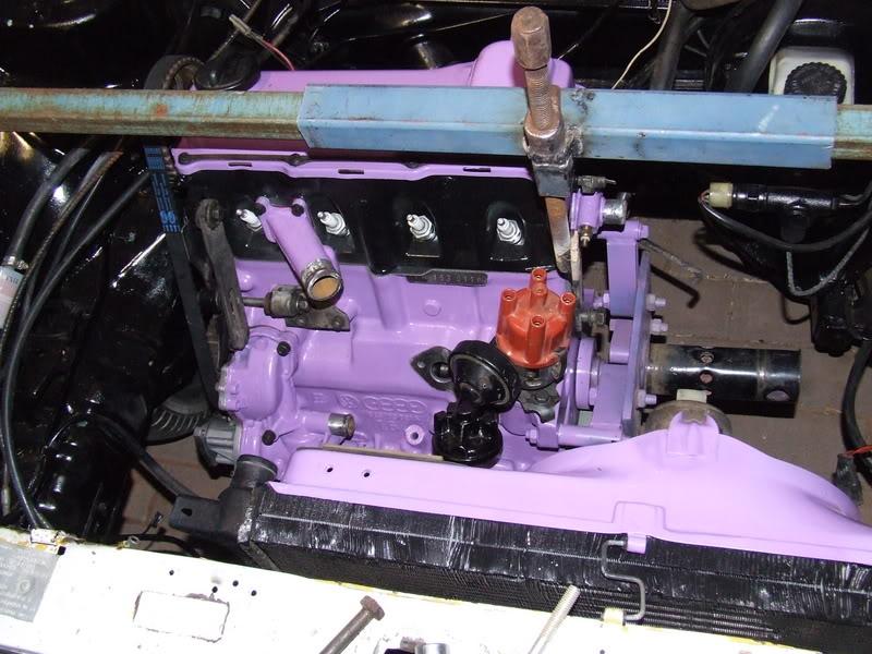

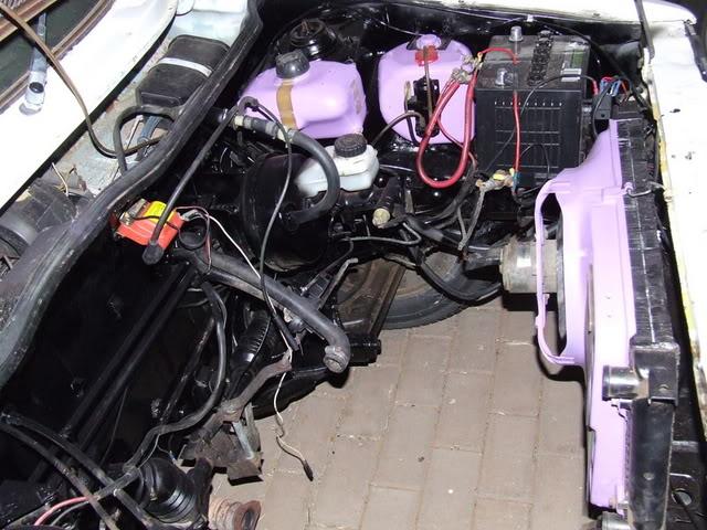

some movement
  • some movement
    slowy slowy getting money to flow
    pay rego weds for second time since
    its been of the road 15 months
    then new 200 mm clutch next week
    and some motivation to finish engine
    build
    painted engine bay maybe a bit to racer boy
    but very bright!!!
    will hear noise soon i hope would kill to drive it again !!!!

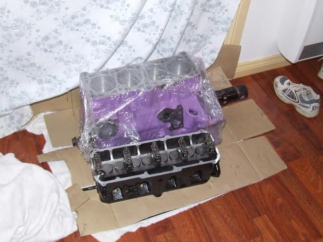

      whats the specs on the engine going to be?
        did post spec's once
        but as car off the road so long
        it's just back to as it was when i got it
        bored out 20 thou
        balanced crank
        40.5 mm and 36 mm valves ported & polished
        nice cam not big but lumpy
        marly pistons (bmw)
        was great to drive but head was cracked under 5 of
        the valve seats which also washed the bore
        hence rebuild
        i really love the head
        that first of motor and head is inside the house
        my wife must really love me?
        been there a month already

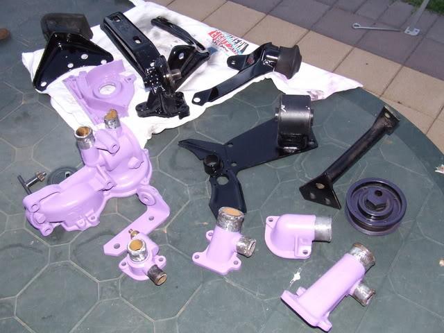

                  finish painting eng parts tonight
                  if it nice day tomorrow i will finish
                  rebuilding engine yay (no shed have to build outside)

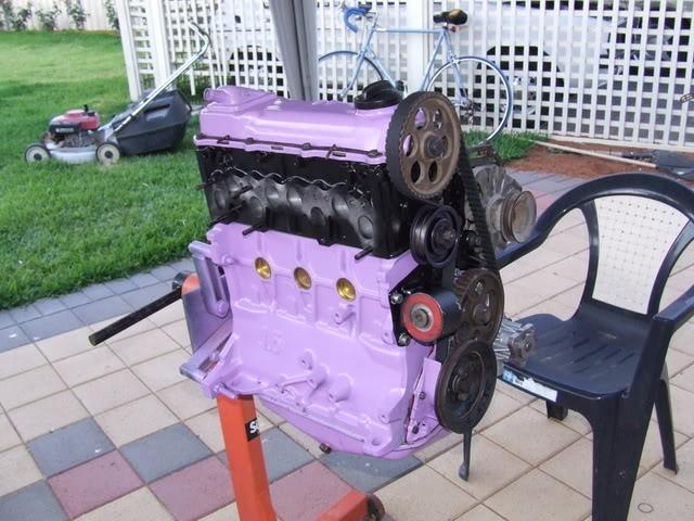

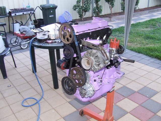

                    got busy this arvo till now
                    engine mostly together
                    then thought its only just dark
                    not easy with only a jack and wife!!
