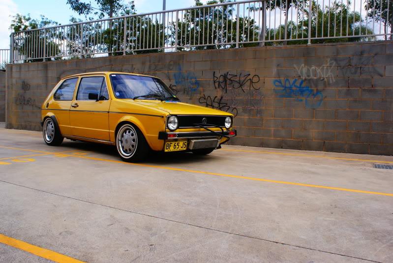

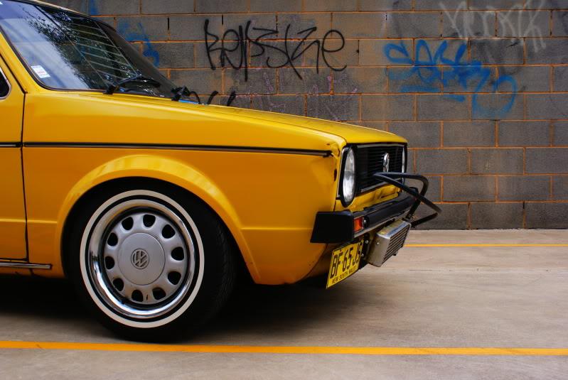

just realised i havent put a pic in here with the cooler all hooked up
