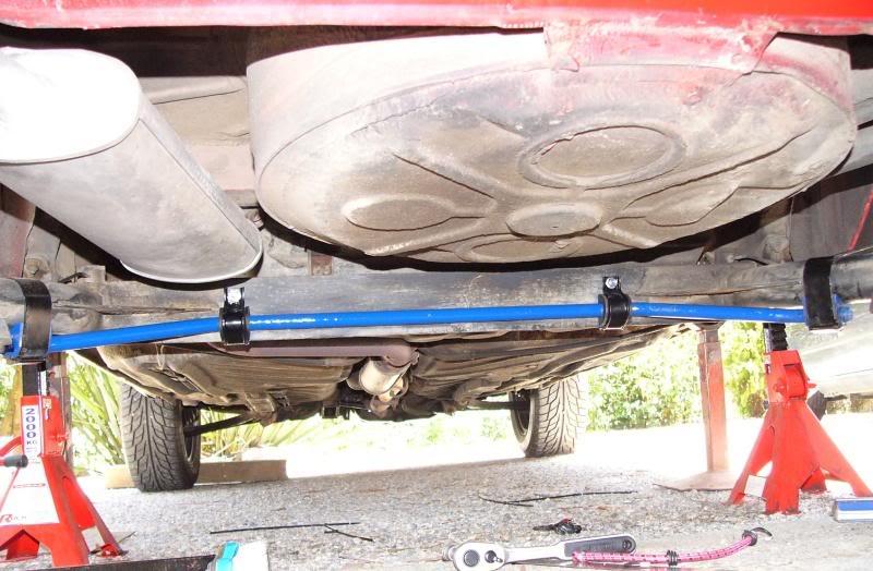

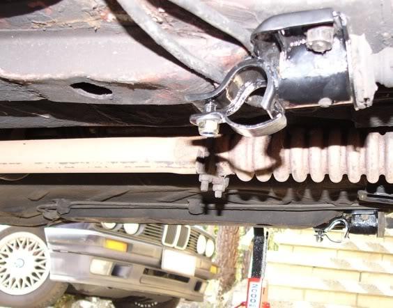

    Anyone got some pics of how the gti sway bar mounts up as stock both front and rear???

      cheers peter, you are a legend now i just need a genuine front sway bar and mounting kit as i have adapted a passat unit to fit my golf

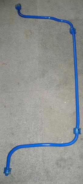

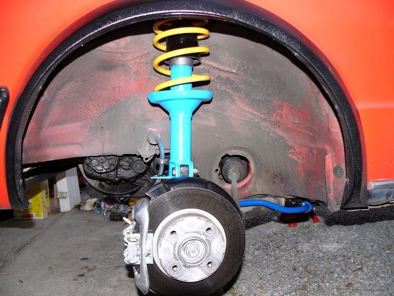

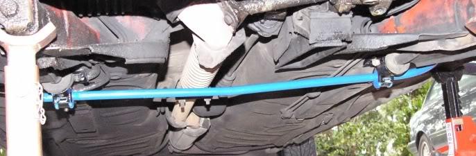

          Cheers guys, I asked the same question once and had to figure it out myself.
          The only bit of information you're missing is where to drill the front arms for the clamp bolts. I just went by eye, but if you'd like a little more accuracy the new arms come with the holes already drilled.
          If you're not using new arms yourself, I could measure mine up for you.
          Pete

            yeah i have the new arms peter so the mounting holes are sweet, where did you get the rear A-arm mounting brackets from if you don't mind me asking???

              Hey Luke, drop in if its your week off and you can measure and check out all the parts.
              The last set of front clamps I got of a wreck in UK. getting hard to find, and as per usual, will likely have to manufacture them in the near future.
              I will ask around the UK contacts to see if there are any spares floating about.
              .The rear straps are becoming hard to find also.

                  I got mine with the sway bay, but I'm sure I've seen them for sale somewhere. I'll have to see what I can dig up.
                  I think the cabbys might have the sway bars too, so if you can find a wreck somewhere you might be lucky.

                    cheers pete that would be much appreciated mate and cheers qldgld. if i find em i'll send em over to have some sets fabbed up.

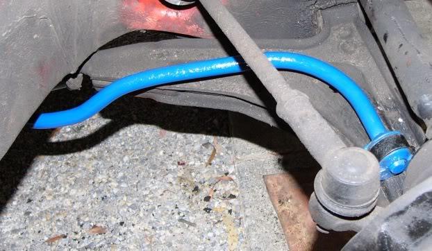

                          Which bit are you asking about? I included this shot to show the sway bar (Blue) from a different angle.
                          If you're asking about the silver bit, it's just a stay for the exhaust, might be peculiar to diesel cars.
