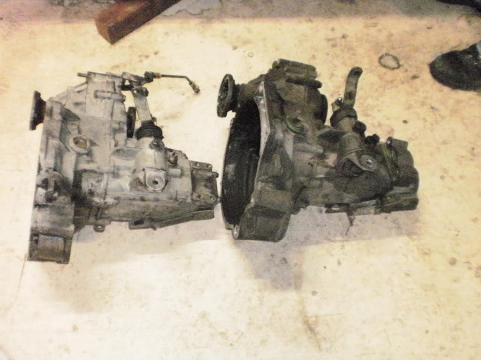

                      four speed out
                      4 speed five speed

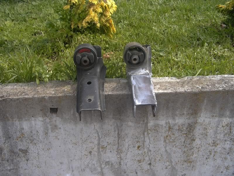

                        dont forget the gearbox mount
                        '98 Mk3 Cabriolet 2.0 8V
                        '99 A4 Quattro 1.8T
                          they dont match
                          the mounts don't match I have to get one from matt.

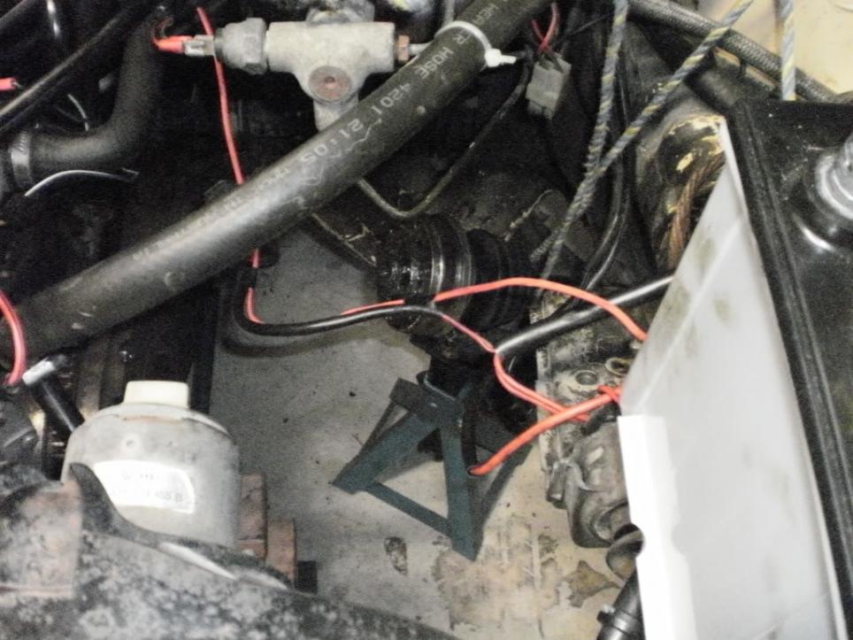

                          whats with the cv studs what a pain in the ass somebody butchered 2 on 1 cv and 3 on the other.
                          I had to beat them out with a cold chisel an 8 mm allen key head would have been fine

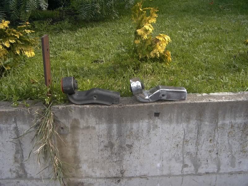

                            I actually thought I put one in the box mate. I had one in the office and now I cant find it.
                            If you are handy with a welder, you can make one pretty easy. Here are some pics nicked from the other thread.
                            Otherwise let me know and i`ll express you one.

                              I will double check on the mount it still could be under the brakes in the box. my life is a little disorganized at the moment. Got a shock to the system today Ive been sitting at a desk for a few years now and have to wear glasses and got gunk and sweat all over them forgotten what its like, first rebuild with four eyes Little stiff as well.
                              Unfortunately the splined studs had a few suss ones , by previous unamed unknown mechanically talented individual. The heads had been beaten before to release them. Thats my story anyway! don' t panic on the mount I will give you a ring, probably will need a few odds and ends as well. Can I replace the splined stud with a simple 8mm allen key head, I have the tool that fits the spline but would prefer allen key thanks again Matt super service!
