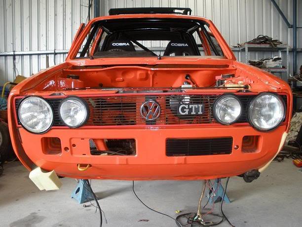

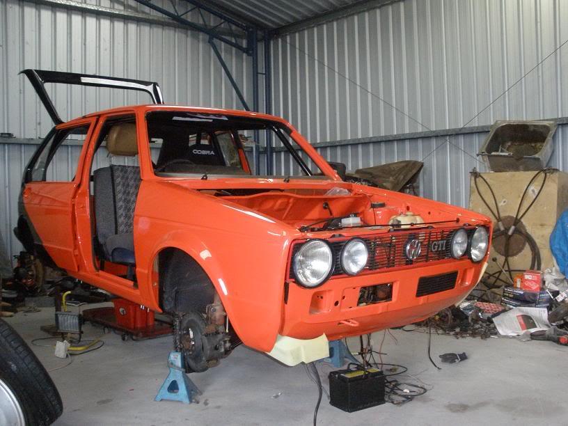

The car on stands half way through the build

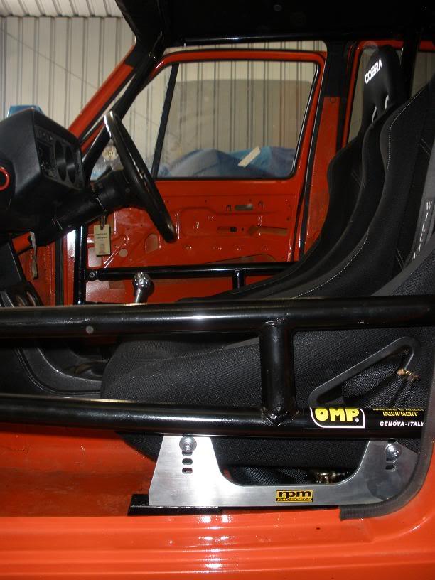

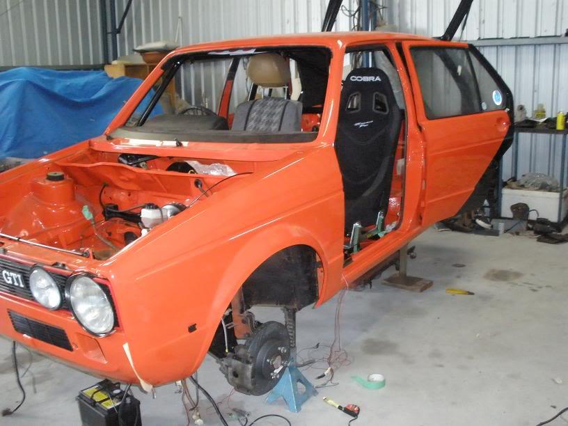

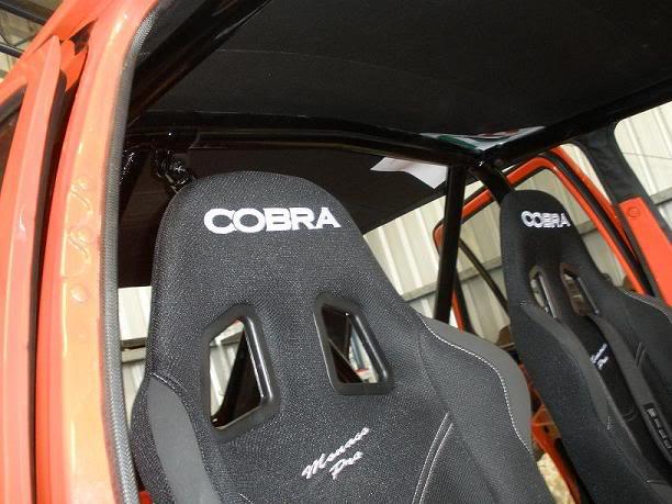

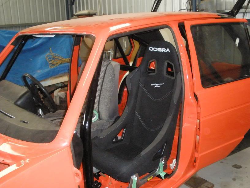

Test fitting of seat with old seat in place to set driving position
New seat looks the part

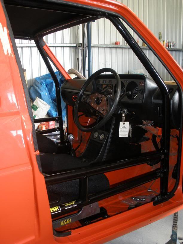

The cage begins to go in

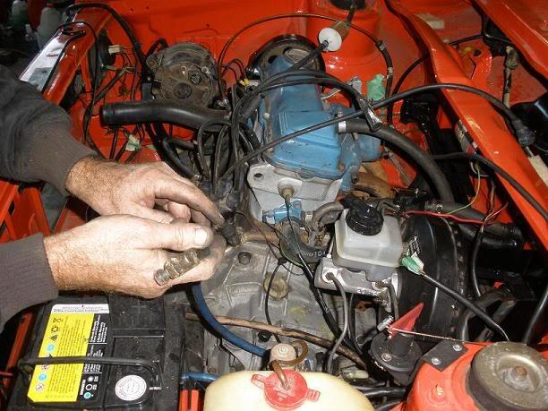

The "little engine" awaiting it's fate with some special gear inside

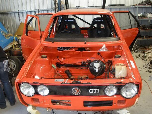

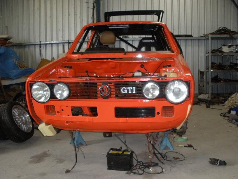

Grille and brake activation rods begin to go in
getting there slowly

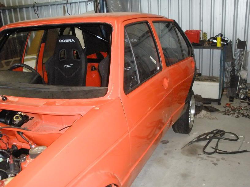

Drivers side doors going on and new seals and windows beginning to be fitted (doors are all early model items which contain no side intrusion bars to save weight)

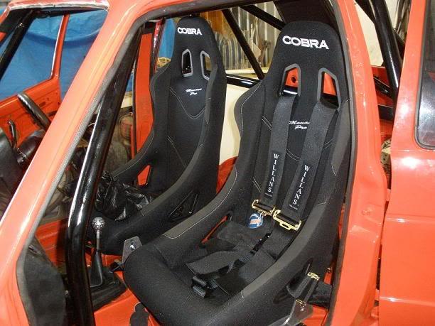

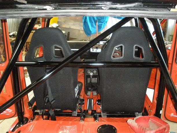

Both seat frames built and bolted in place, harnesses getting installed

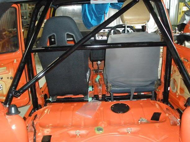

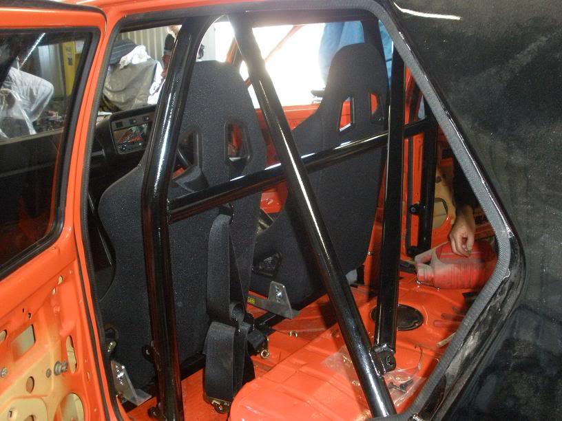

Harnesses being installed around the rear cage
Rear section of cage and codriver harness fully fitted

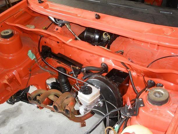

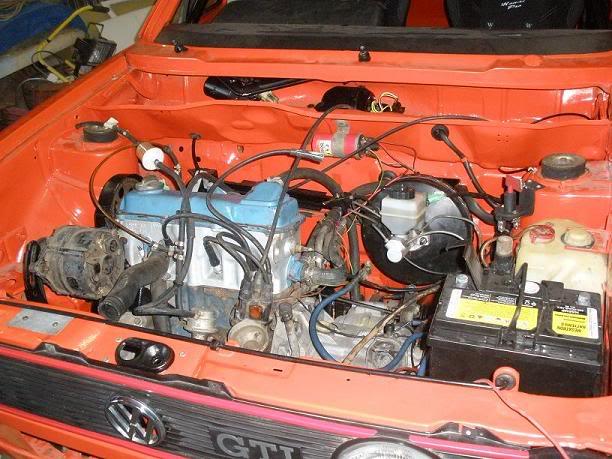

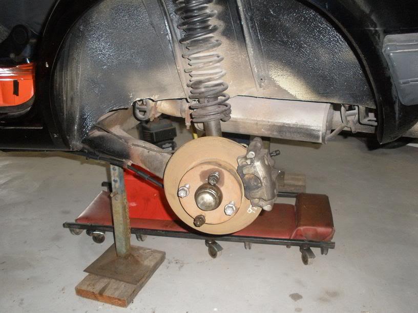

9" Brake booster and 22mm master cylinder modified and installed (Thanks Peter Jones
lights and engine accessories wired up

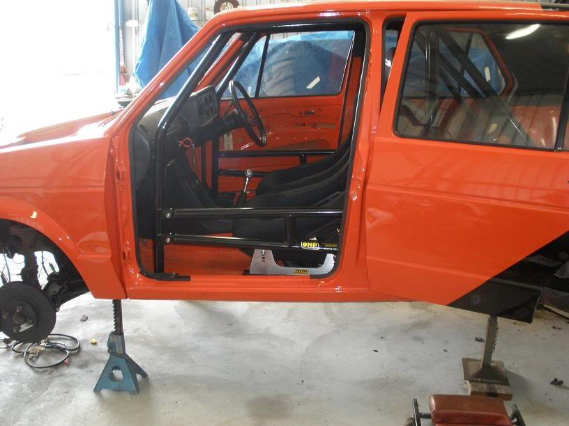

The front cage now fully installed and door bars fitted
more bars
Still more bar shots, nice and solid
Drivers side bars, still room to get in and out

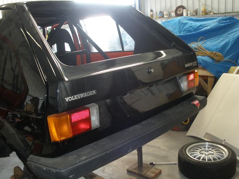

New badges for the hatch and new tail lights

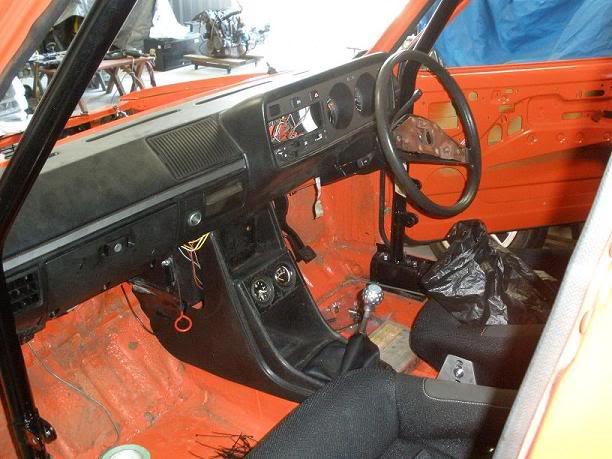

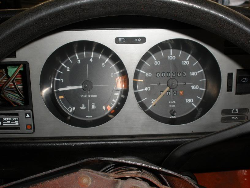

Dash fully rebuilt with all new switches and warning lights and speedo reset to zero for the ground up rebuild

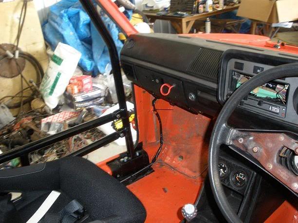

Remote battery cut installed into new glovebox (it hurt drilling that hole into a new glove box!)

Co-driver side doors all fitted with new seals and glass (next month i'm changing them out for plexiglass)

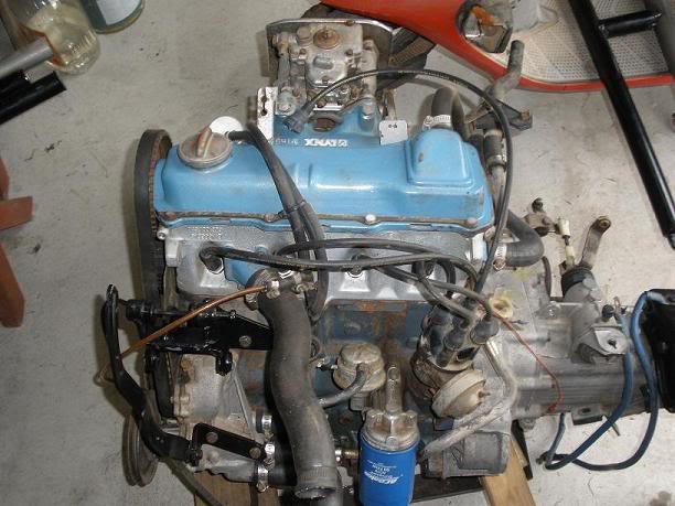

Engine slipped into place
WIring the old girl up

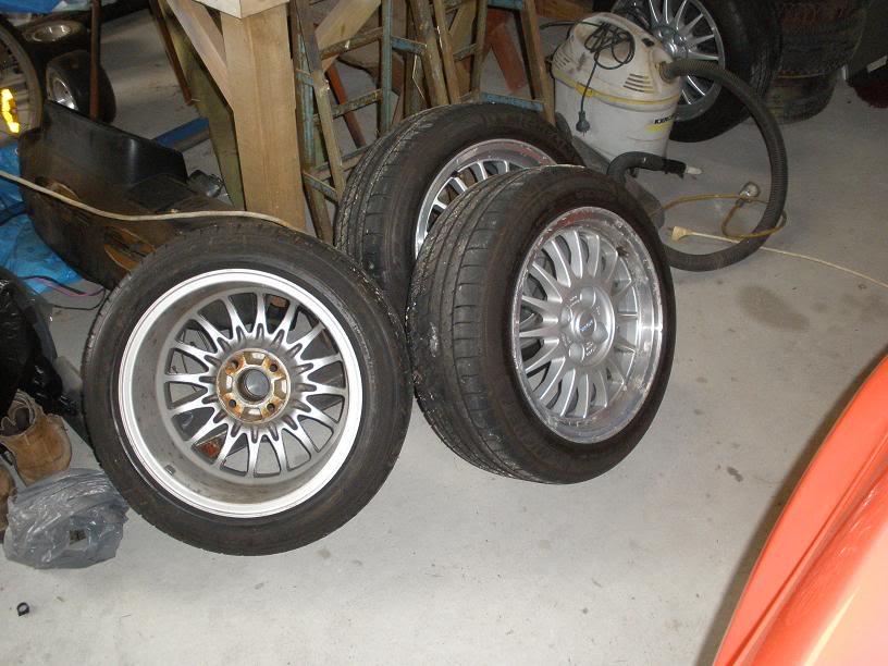

15 x 7" Ronal motor sport rims yet to be fitted with 225 x 50 x 15 Kumho V70A race tyres. Big thanks to Dom and Tim for the rims. The give the car a nice fat look.

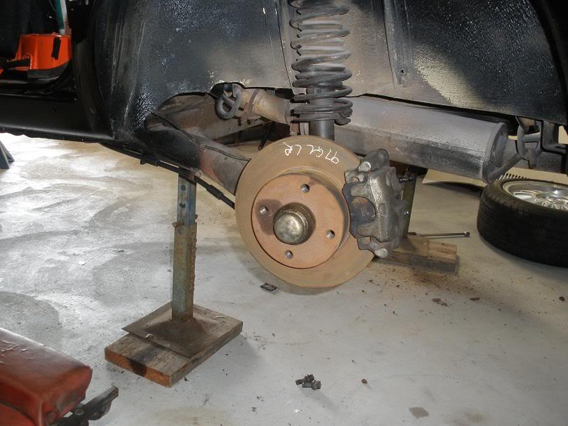

are you going to get enough coverage with those pads??what size are the disc's
