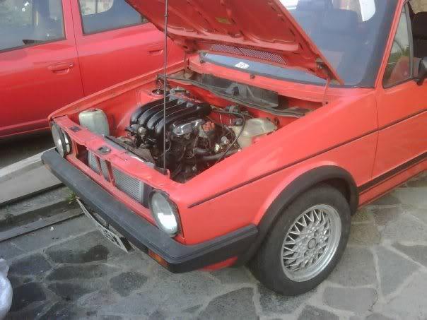

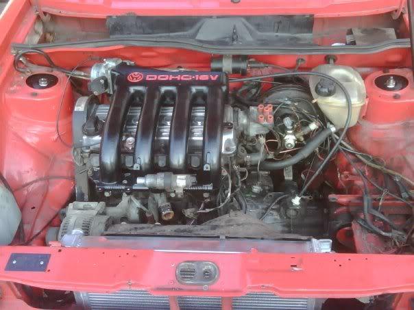

    A mate in the UK is doing a Mk3 GTi engine conversion into a Mk1.
