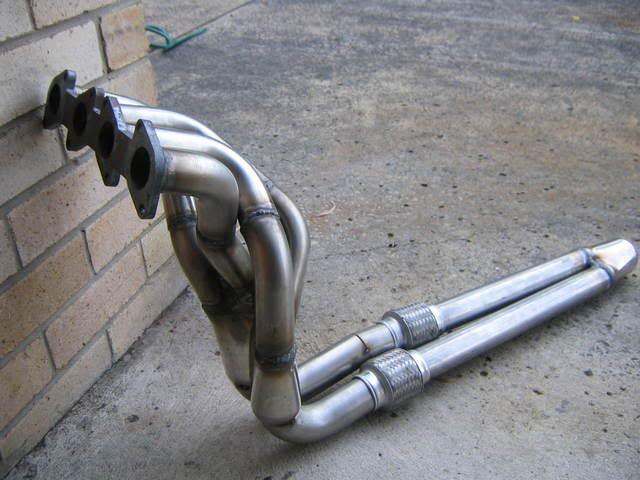

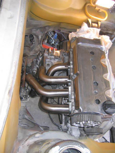

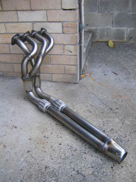

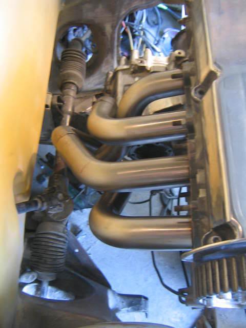

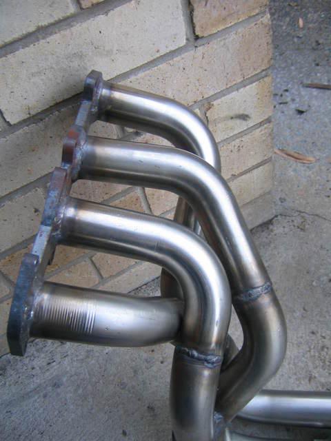

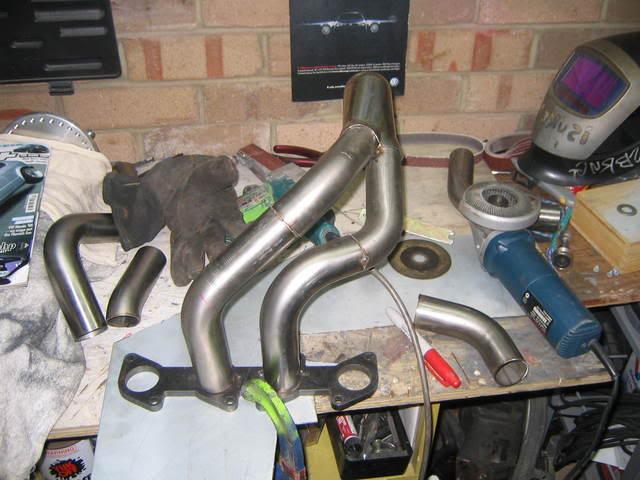

finally got hold of the bends and gear to get a start on the header,306 stainless 1 3/4 primarys to 2 inch secondarys to 2 1/2 exhaust.

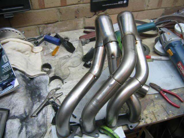

it was quite hard to get started but once i had a start i e general shape and length depth it went quite well, will be finishing welding it soon
enjoy

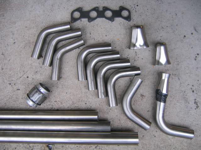

a few hundred dollars worth of bends
and a watercut flange
it got easier from hear
