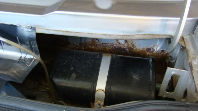

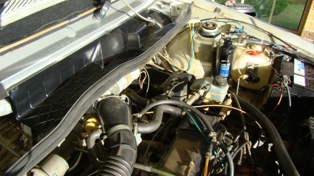

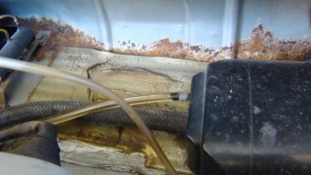

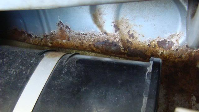

When I bought this a few weeks back I noticed a bit of surface rust up on the firewall near this black cannister thingy...

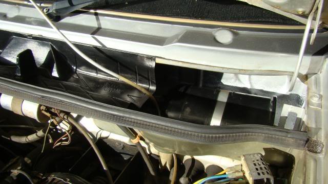

So today I got stuck in, pulled it out, scraped it back with a wire brush, gave it a light coat of rust converter and then sprayed it with Killrust paint.

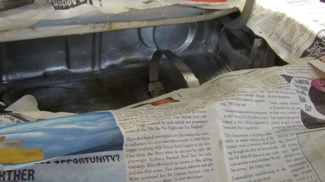

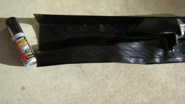

I used Forever Black on this plastic thingy..
Finished painting..

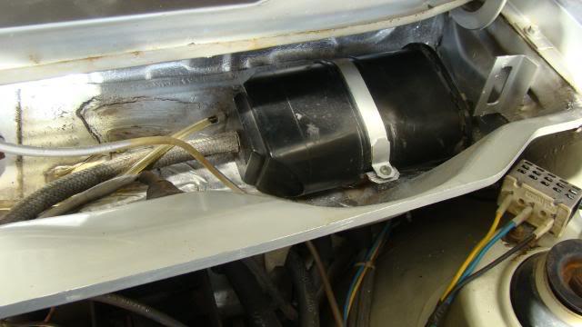

Can anybody tell me where this hose is supposed to connect up to?
If I did anything wrong, can someone tell me before I make myself look like an idiot??

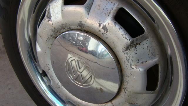

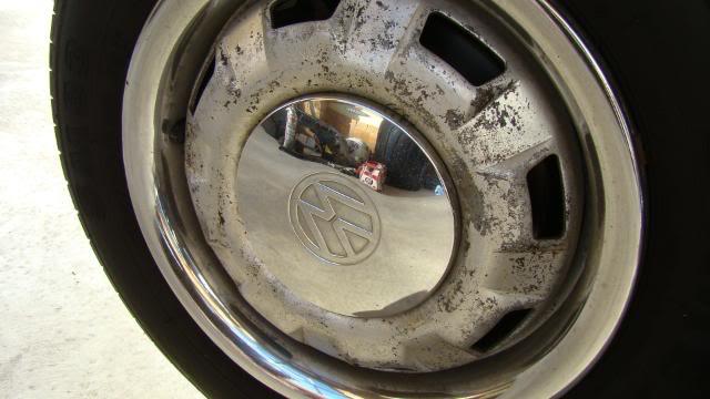

I would like to ask for opinions on the wheels too - they look pretty rough. What should I do to them to get them back to looking original?
