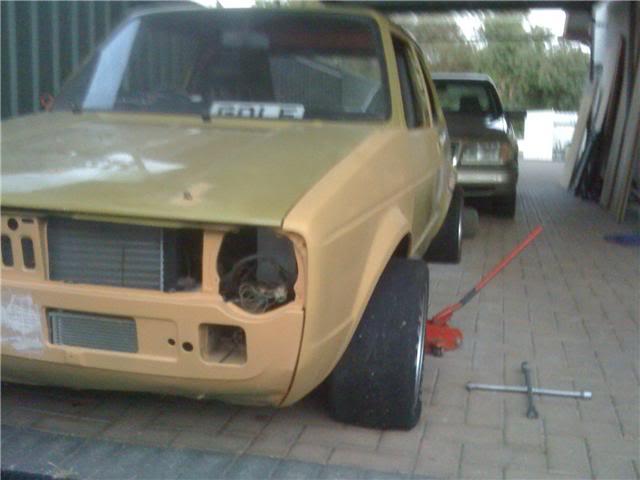

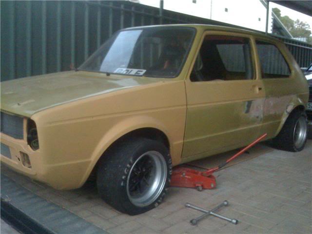

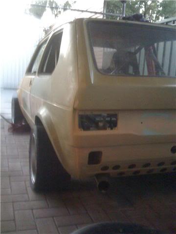

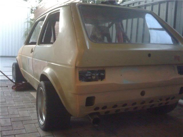

                          • #28
                            Originally posted by Grunmk1 View Post
                            Would love to see your car.
                            Not sure joel will put a build thread up so some teaser pics
                            • #29
                              OMG!
                              Now THATS what I call poke!
                              Berg cup arches and front splitter please <3
                              • #30
                                Originally posted by cam0x View Post
                                OMG!
                                He's on it...
