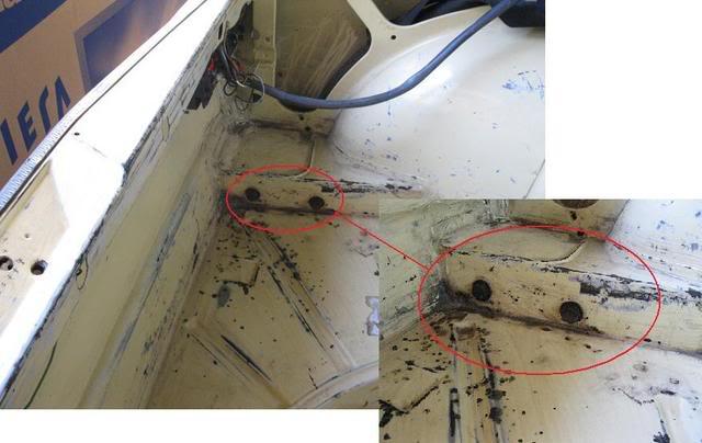

    i thought you just undid the bolts inside the hatch bit then it slid out?
    2 on each side down on the left and right of the wheel well but more to the back?..

        The bolts are inside the boot not the bumper. You remove the brackets from the car with the bumper still attatched to them. You're trying to take the bumper off the brackets while it's still on the car
        Bring some stellas over and I'll fit a new bumper for you
          heres the buggers i was talkin about (photos from a very clean golf.. lol)
          but yeah, 2 each side, crank em!

            D'oh! I knew there had to be an easier way! I just assumed you remove it from brackets, and, being an old VW, is just a bitch of a thing to get at.
