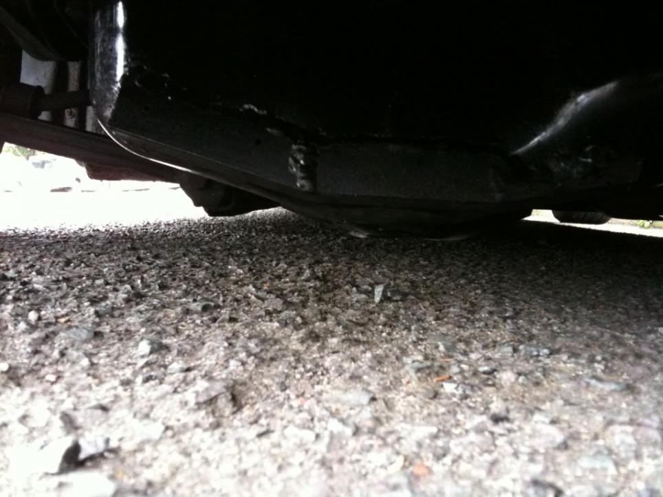

  • So I took one photo today but not on straight road will do that on the weekend for sure but I measured it in my garage and could only get 3 fingers in under the sump sorta.
    But heres one I did this morning
    • hopefully my sump will be as close as yours to the ground.

        • damn, that's low steve.
          Have you got any protection for the sump near the bolt?? or just that thcker stuff on the 'front' of the sump there?
          • Originally posted by Spyda View Post
            I like it.
            It now sits a little lower
            I have just like the front angle covering the sump plug but, I need to take the sump plug out with a rachet instead of a spanner thats the only problem other than that nothing really.
