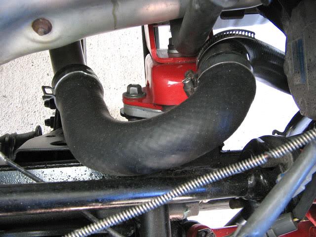

    Go to Burson's & get a generic length of hose with a tight U-bend in it.
    Make sure it's the same I.D. (internal diameter) though
    You want something tighter than this though.
    I think a XF ford may have a long heater hose with a tight U-bend in it from memory.
      i have done this and you must have return flow. A camira water hose is the exact same diameter and has a perfect 180 degree bend to return the water

          If you have warm air coming out of the vents all the time, try fitting a new valve. They wear out over time and don't seal that well, allowing water to circulate in the heater core.

            I am having the hot air issue, and just think that this method will do for summer and reconnect it in winter.
            But, it may lead to the core drying out and rusting? I dont know... that is why I was thinking a diverter valve. So the water stays in the core keeping it wet.
              Just get a new tap, or clean the old one, they can get full of crud.
