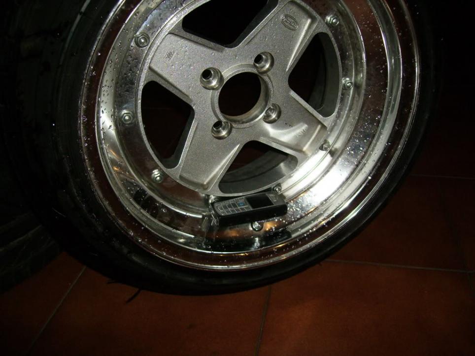

    I'm looking at picking up a Mk1 as a daily, but I'd like to be able to run some of my MX5 wheels as they'd fit in with what I see some of the European and American guys doing, but I don't know what you can fit under a Golf without needing reallllly pumped guards.
    So does anyone know what sort of widths and offsets you can squeeze in? I'm not asking what is legal and what isnt (because nothing good is ever legal lol), I just want to know what people are fitting in their guards.
    The wheels I'd *like* to be able to run are my SSR Mk2's, 15x8 +12 (F) and 15x8.5 +6 (R) but I've a feeling that may be pushing it a bit... I'd like to be proven wrong though
