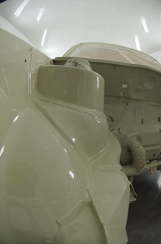

    its been simmering for a year or so. both my painter and mech crew moved sheds in last few months so i have been able to get cracking now settled. thanks heaps to showdown customs and kaizen garage for the garage space and help..
    finished the core bodywork sixmonths ago so i best put some progress up!
    swallowtail, seventy something (cant find the plates atm!!) it was previously painted in some white house paint!! 100 6" discs of 60 grit later..
    have to finish rubbing back the bay tonight (2pac primer), hopefully for paint tommorow..
    general engine bay de-clutter also deleted the euro wiper mud puddles.
    my painters car- 'roller levin 20v, candy paint is sweet at night and the scissor doors are pretty funny..

    cool project. what colour are you going to paint it??
    nice turbo on that ae86 in the background!!
      keep us posted... sounds like a nutty project
        good work looks like the beginning of good things

              colour is the new mini 'pepper white' paint is schuberts 2k colour then clear over the top. didnt want to have to buff solid colour!

                        phew. the paint is done..allthose hours of hand blocking should pay off!!

                          paint looks awesome dude. looks like its coming along real quick!! keep it up
