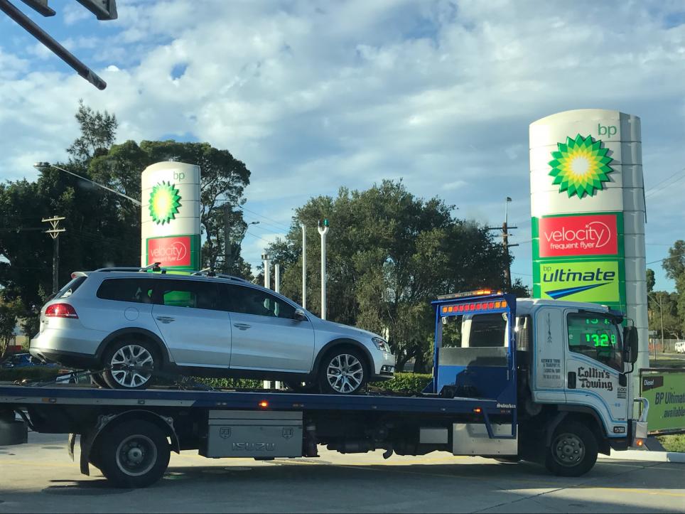

    Get a call from my wife about what to do if someone hypothetically put the wrong fuel in a car......
    She stopped at 8L of BP ultimate.... Unleaded.
    At least she had the presence of mind not to just fill with diesel on top.
    Got her towed to local garage and they are sussing out what to do now.
    Car was not started but keys did go in to put in neutral & disengage park brake.
    Does anyone know the best process as these guys are not VW mechanics. They are proposing to syphon out tank measuring what comes out. Then just top up and run it.
