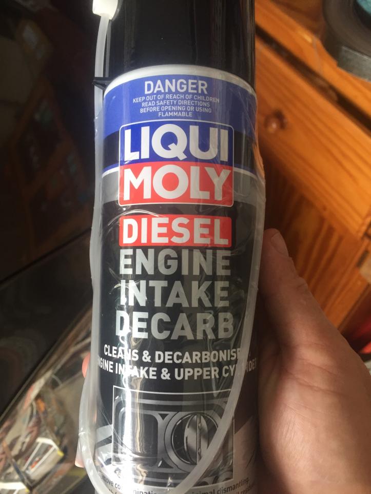

    Got a can of liquid moly decarb spray today and just wondered if anyone has used it before, what the results were (if any) and how best to get it into the intake? I'm guessing after the maf but not sure as the instructions are basic.
    It's a 2011 CEGA 2.0cr TDI off a octavia Rs

    Don't put it in after the MAF, as it'll sit in the intercooler and become one huge lump of liquid ready to be ingested as soon as you hit boost.
    I'd vote go in through the EGR valve, or take it somewhere like Camden GTI and get them to do it.
    They've been heavily involved in a CEGA before.
    Not including hers...
      Much harder to do on a diesel. Need to get it in somewhere close to the intake flap.
      I don't find it as effective on diesels as the petrol version is on petrol engines.
      You'd get much better results physically removing the EGR and intake flap, and cleaning them by hand with brake cleaner and a few different types of stiff brush.

          The best way is to unbolt your EGR pipe at the intake flap, with the engine off, and pump that area full. Try and get the hose up in towards the manifold / four inlet ports. Bolt the EGR pipe back up and let it sit for a good while, and then try and start the car, which will take a bit of cranking. It will struggle and run rough till it clears. The next step is to spray it in with the engine running, I do it on idle and just stop as it labours, but I put it in PRE TURBO where the PCV inlet just before the turbo is in the air intake. The idea of a big pool in the intercooler is false, for sure you end up with some, but the whole idea is to get rid of buildup. Your intercooler ends up with a nice layer or engine oil from the turbo bearings anyway, don't kid yourself it stays nice and clean, better to try and flush it out a bit with these sorts of sprays. For sure they don't beat a physical clean, but who really bothers in the general public, as it's a super dirty job. These sprays sure beat doing nothing!
          Put it in anywhere AFTER the MAF and you will get some effect, diesels are alot tougher than people think. The REAL issue is all this crap ends up in your DPF, whether cleaned out via spray or not, I think you should all worry more about that!

            The diesel version can't be anywhere near as volatile / combustable for obvious reasons, I agree it's poor in comparison. Putting the petrol version through a diesel is possible, I do it from time to time, but you have to limit the airflow to avoid redlining it!
              Thanks for the replies guys! I thought about taking the manifold off and cleaning it with oven cleaner and a bit of elbow grease like I did on my BKD TDi but it was a prick of a job and it's a bit more complex on the CEGA! The instructions say hold the rpm at 2000 and empty contents of can but if the revs increase (I'm guessing the motor using the contents of the can as a fuel) then shut it off.

                            I've used this product.
                            Followed the instructions in the vendor's youtube clip:
                            Was on my wife's TDI golf, which tends to do quite a few short trips for school bus pickup etc. Had come up with a potential EGR valve fault (although it may have been a bad battery).
                            Certainly was stuff cleaned up by this - engine responsiveness and power seemed better (confirmation bias perhaps?), but didn't see a measurable change in fuel economy etc. However, the engine fault light hasn't come back.

                              I used it yesterday actually and haven't really noticed any major changes to be honest! I put it in just after the maf but before the turbo. Like you I followed the instruction but can't help but wonder if it may of been better if I'd taken off the egr inlet and sprayed in through that despite the trouble?!
