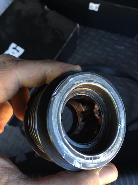

    Last week when I left for work I noticed an odd smell and noise coming from the car. Opened up the hood to find my alternator pulley had exploded and made a mess of my engine bay, haha. The smell was the rubber belt burning and throwing rubber around.

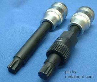

    I lurked the forum and found out this isn't exactly an uncommon issue on the model and went ahead and ordered a new belt and pulley, along with the 33 spline socket tool to get the job done, from online.

              I would think if the old pulley was 'working' prior to failure you could expect some damage to the splines which, I would think, bring on another failure due to a return to 'working' immediately.
              I would be taking a very close look at the splines before making any decision unless you're into gambling.
                The splines are in the pulley that is thrown in the bin. The only reason for the splines is you can hold the assembly[with the special tool] while you remove & install the centre screw.

                      Ok, so the pulley has both male and female splines?.

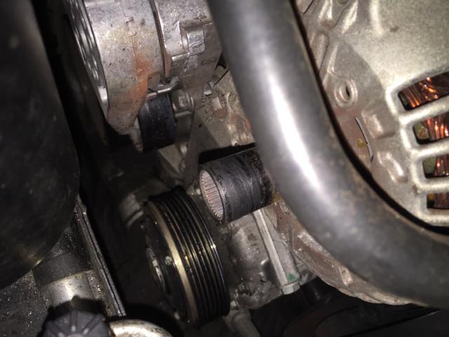

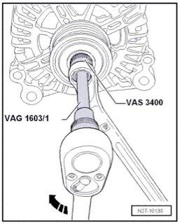

                        Jets can correct me if I'm wrong, but to the best of my knowledge there are two female splines as part of the pulley assembly. The 33 tooth one is used to stop the alternator from spinning while undoing the inner bolt that holds the pulley itself in place.
                        Like so:
                          The pulley itself screws onto the alternator shaft.
                          The 33 tooth bit screws the pulley off while the double square bit holds the shaft or vise versa.

                              Once I got the right tools in hand it was a quick and easy job, took all of 5 minutes to swap out pulley and refit the new belt. Little longer to take off wheel and inner guard too.
                              I was working under the impression that the centre bolt was a T50 Torx bit at first and kept having troubles with it slipping, upon closer inspection it was a size 10 spline bit, had no issues once that was in there.
