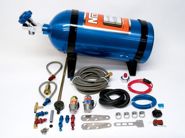

          I like this LPG kit.
                I like this LPG kit...
                wouldn't this mean that you will be paying more at the pump? A tank of diesel + a tank of LPG?
