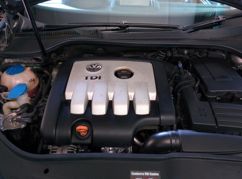

          Yeah I havent opened up the inlet for a look yet, but it does look as though its had a new ASV in the last year, as its super shiny. It does have plenty of power though, so I dont think its as clogged as it could be. It certainly hasnt been a town car, so it should have stayed pretty clean being driven on boost most of the time.

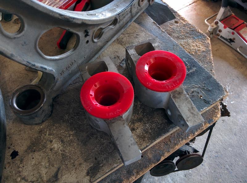

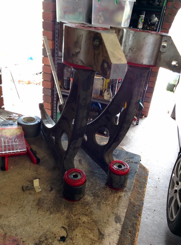

                        Of course, everyone needs nolathane bushings in a daily:
                        I did some engine bay detailing a few weeks back, still looks good apart from the smudges on my engine cover!
                        seriously though - the nolathane bushings are fantastic. I put a superpro Supalloy wishbone kit in the Octavia when I owned it, and to be honest for the money, for a road car, its about 6 times better value to buy Nolathane bushings instead. The nolathane bushings are a little harder to get in, as the fronts seem a little fatter (lengthways, not bore size) than the superpro - but apart from that the net effect for driving feel is identical and it also feels like there is a little less NVH with the nolathane + stock steel wishbones, vs the supalloy wishbone kit.
                        I would also tentatively say that the nolathanes are making the ride even a bit nicer than stock, since theres no stored energy in the bushings.
                        for $100 all up, you cant go wrong really.
