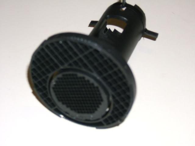

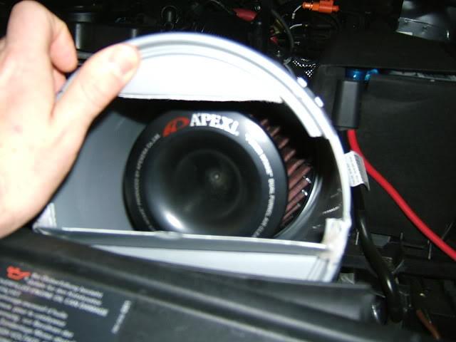

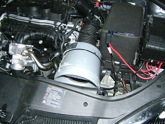

                        MAFgrid-less with my temporary bucket pod and absolutely no problems thus far.... but boy isn't the response better!
                        You have to fold back 4 tabs on the front side of the maf grid, around the edge. They are very small, like only 1mm wide, and it's obviously been melted together, but they are easily peeled back with a small screwdriver. Taking the top sensor out is tricky with the special star screws, but gotta love the multigrips. Getting the whole assembly out is tricky as it clips into the rear 3 arm holder, and despite several attempts to just unclip the rear, I got the poops and just took to it with the cutters. It would just push back in and need three spots glued to be back to stock. I'll drive it a few more days and watch for any vag com errors, but yesterday the car ran exactly as per usual, even idle was perfect from the first start.
                        I've been chatting to Steve at Modshack, and am getting a custom housing off him at a very reasonable $150 odd less filter. Thanks for pioneering this for us here Mik!
                          Gotta love the 1 kg protein bucket!
                          It's actually the same size as Modshacks TTDA, shorter yet fatter filter, and with one thin hose from the radiator lengthened will fit a treat.
                          Boy don't you feel the hot air from the engine when you've been idling in traffic for a while! My proper housing will be sealed to the front intake to prevent the hot air ingress as much as possible.
