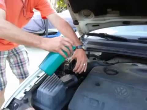

    Typed in 'turbo siren sound TDI' and there seemed to be an answer.....seized vanes....VNT turbo....and the solution???
    Mr Muscle yes oven cleaner the NaOH variety......
    So we set about removing the dump pipe to have a look, turbo vanes perfect, no axial or radial play in the shaft (as expected). So Mr Muscle it was.....45 mins of soaking, a big rev and miraculously....warning cleared itself, siren gone and drives like a bought one...HAPPY DAYS!!!!
    Driven considerable distance since under various load conditions and performing perfectly.
    We made a replacement dump pipe so the muck didn't pass through the cat, total cost including Mr Muscle $23, and NO we didn't contact the previous owner to gloat......

      We went to quite a bit of trouble to inject the cleaner into the turbo beyond the vanes and ensure that none of it found its way onto driveshafts etc.
      Amazing how long we could run the engine through 2 inch PVC pipe with alfoil used to insulate the plastic dump pipes 90 degree bend.

                          Post Mr Muscle the noise is different. Before the turbo seemed to spool up momentarily after you released the throttle and seemed slow to spin down,
                          something like this ( video is no load though)
                          once the vanes were free (could physically feel the difference on the actuator) it was immediately obvious that the turbo slowed faster (vanes opening fully). Now sounds like any wastegated turbo....
