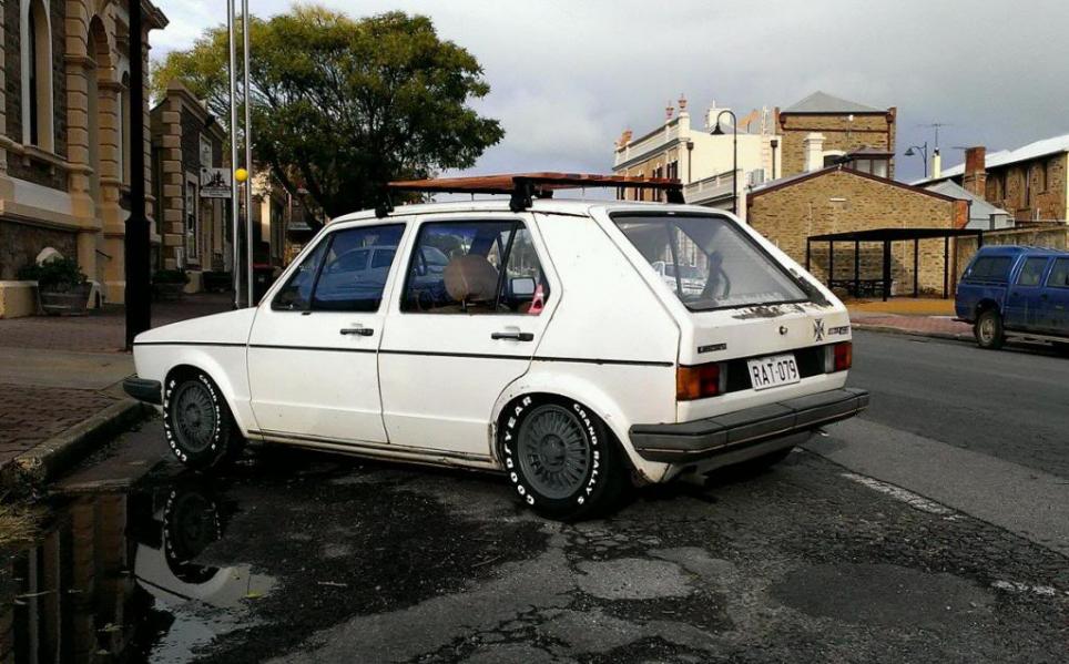

    I've owned two GLD's over the past year or so, both unfortunately succumbed to defects though (one too low and one for engine smoke) and I should be picking up my third soon
    First one:

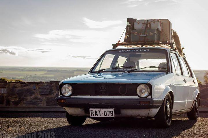

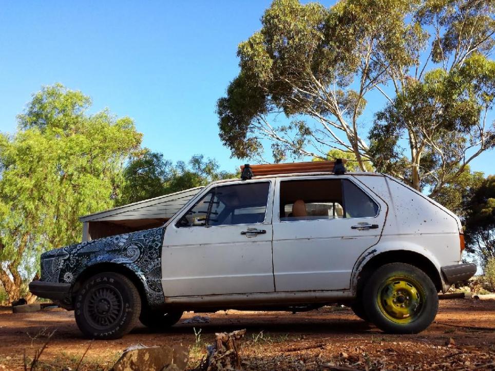

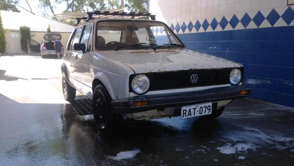

    Second one:

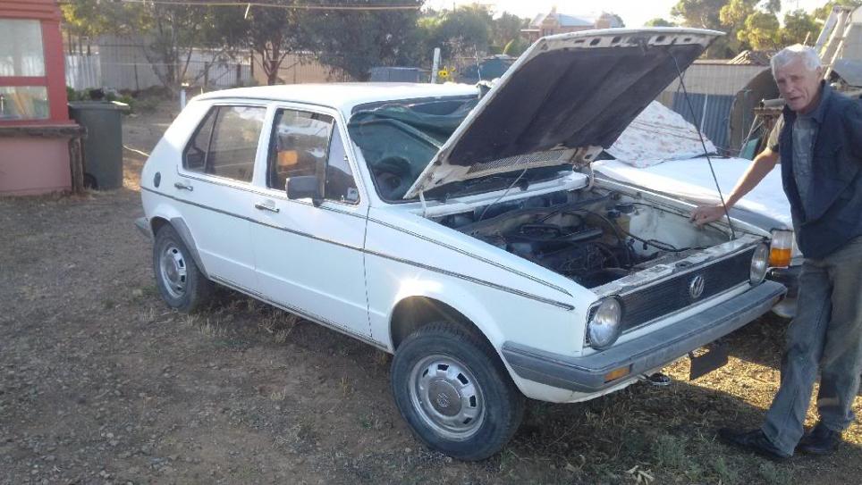

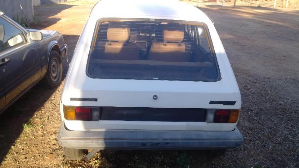

    New one:
