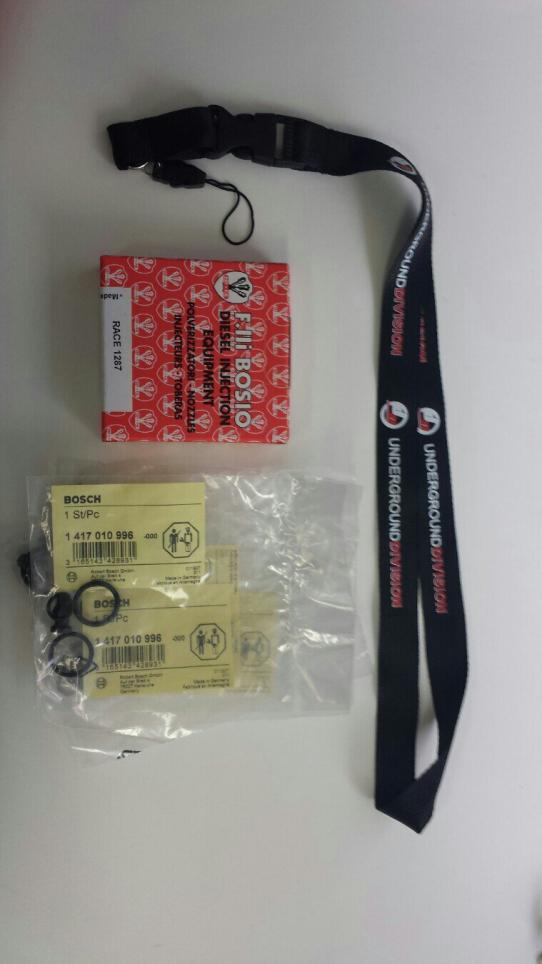

          • #20
            Just received these bad boys at work today. Can't wait to install them.
            Sent from my GT-I9505 using Tapatalk

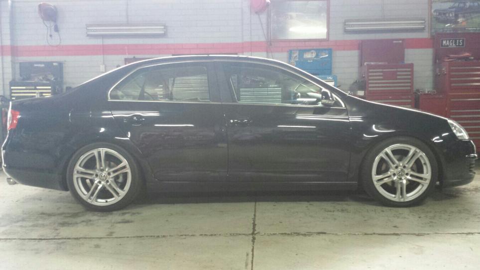

                        • #27
                          Just picked up my car! Love it even more now.

                            • #29
                              Hey, the nozzles are finally being installed and tested before they go into the car. The car is running without any issues apart from the abs sensor that popped up one night after the drags. The tune cost me $350 with many free updates. The tune box costs $200 I think but you can lease it from Malone. Yes Malone supplied me a base tune and then every update was refined for free. I am aiming 300hp and 650nm of torque. Hopefully I can reach that amount smoke-free.
                              • #30
