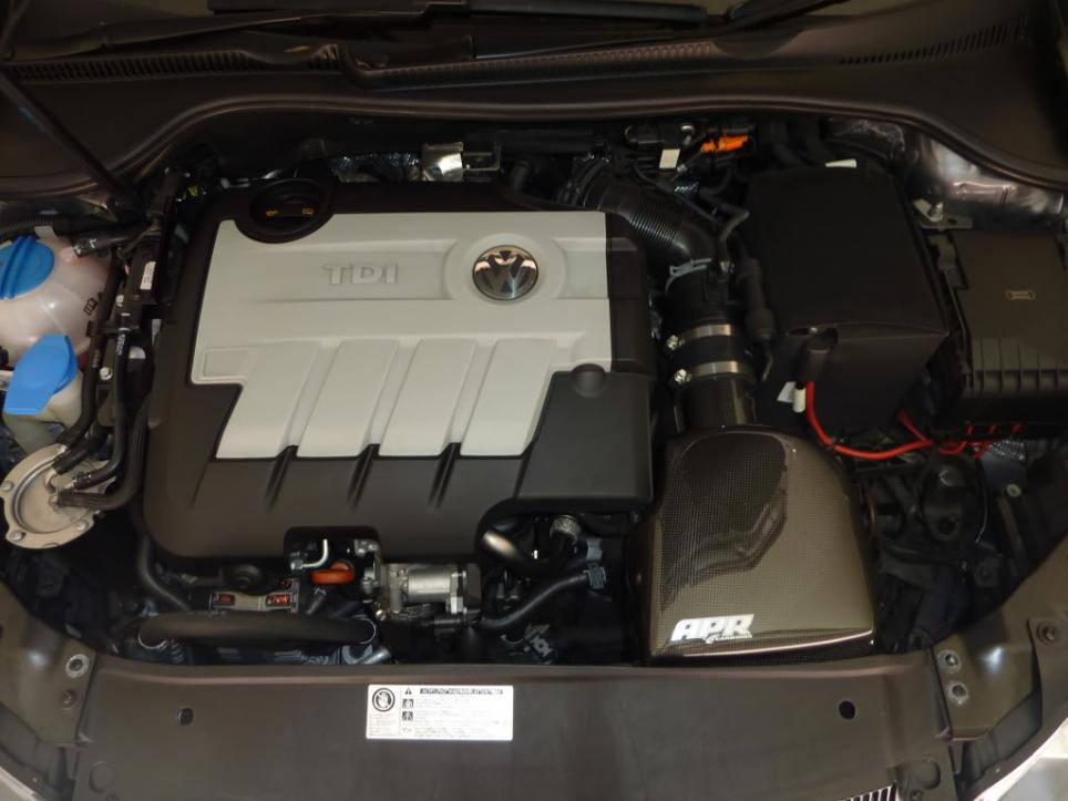

                            If you have a look at this picture of the APR setup.
                            and then of the stock..
                            Where are the improvements of 'direct air with less turns'? Nothing is replaced except for the shroud at the front, there is no bigger intake pipe, there is nothing, its a really expensive cosmetic mod that might make your car sound 'cool'.
