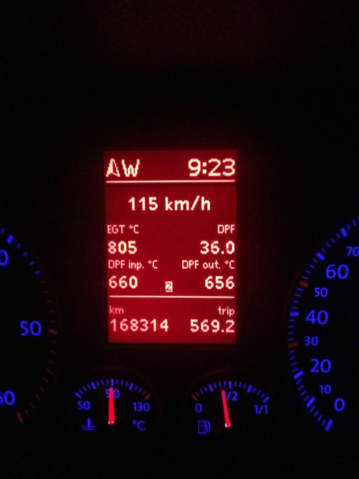

      • #18
        Now THIS is a proper regen
        • #19
          I hope that was on the motorway!!
          You need to keep EGT's above 600 to get a proper burn, but your inlet flap will sort that out. I have to do that manually, and it's actually hard to keep EGT's up enough to get a full burn if not on the highway.
          • #20
            Originally posted by Mysticality View Post
            Hey, guys!
            Just chiming in... What do these values mean?
            They're from the 18th of April, so an easy 15-25,000km ago...
            EDIT: It did a regen on the way home from the bloke with the VCDS, 100km trip - about 5k's in.
            Without going right into it, all is well, and you are doing better soot wise than the car calculates you should - at that period in time anyway.
            You Mark 6 guys don't need to worry till you hit 100,000k, it's the MKV guys like me in that sort of tiger country now.
            • #21
              Yeah it was
              It will do it on a normal road as well...

                • #23
                  Hi,
                  How do you get the dpf info to show in the DIS like that?
                  Thanks,
                  Rick
                  • #24
                    Hi,
                    How do you get the dpf info to display in the DIS?
                    Thanks,
                    Rick
                    • #25
                      Originally posted by Rick86 View Post
                      Hi,
                      Thanks,
                      Rick
                      Hey Rick
                      I installed a Polar FIS+
                      Not cheap but I love mine
