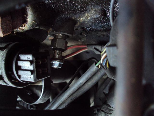

    It strikes me, when looking at the bus bar, that there are no thick wires connecting to it; only these two, thin red and white wires, which I find hard to imagine being able to carry about forty amps at twelve volts.
    Image showing first glow plug with bus bar by the connector for water temps, disconnected for better view.

      Yes, I agree. I'm also suspecting the relay. What do you think of the thin cables to the bus bar, though? Are they enough to carry these forty or so amps to the glow plugs? I think I learnt in school that low voltage needs thicker cables.
        Well, the ones in your picture do look just like the ones I had on my old mk3 TD - I never had any problems. In 150,000km I only changed the glow plugs once, that was all.

                Well, I changed the glow plugs, and it still didn't work. Took it to an experienced mechanic - forty years in the job, with no other hobby or wife - and after doing the same testing as I did, he found that there was no voltage on the bus bar. He opened up the relay, OK'd it and went on to pull apart the contact where the wires to the bus bar come from. He put silicone around the contacts, put it back together, and the car started just fine.
