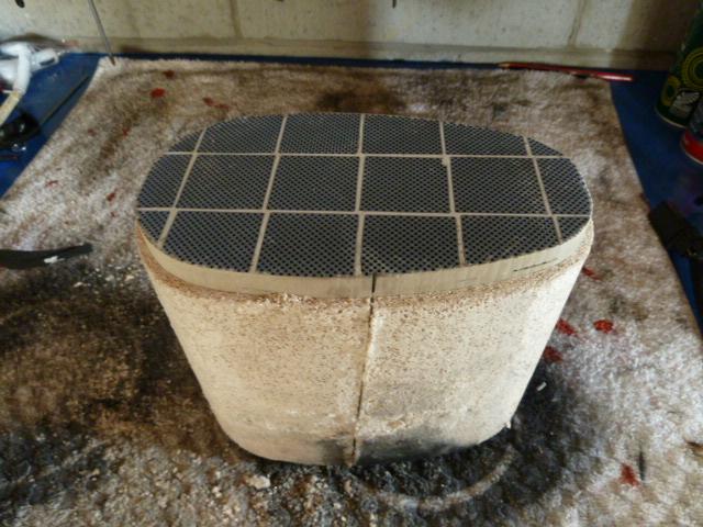

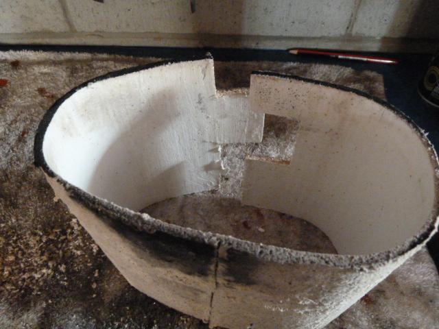

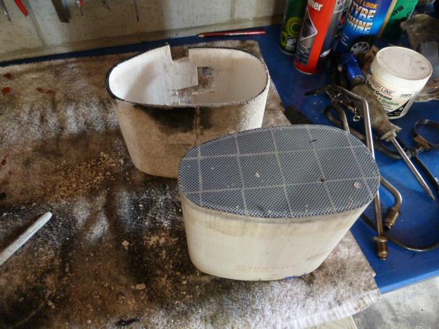

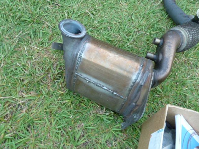

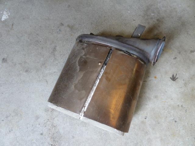

    With the DPF out, it was time to cut it open with the aim of not damaging the core. As you can see from the pics below, it sits on a small ledge top and bottom, so I cut a little above the lower weld, so as to not damage this shelf, and also used a worn down 1mm cutting blade so as to limit my entry depth. You can see I still nicked the core in a few spots. The first pic is my prototype DPF and you can see I cut a bit too low. You can see the core is about 2mm below the case, wrapped in some sort of heat shield stuff, probably asbestos, so take care!! I used a mask just in case.

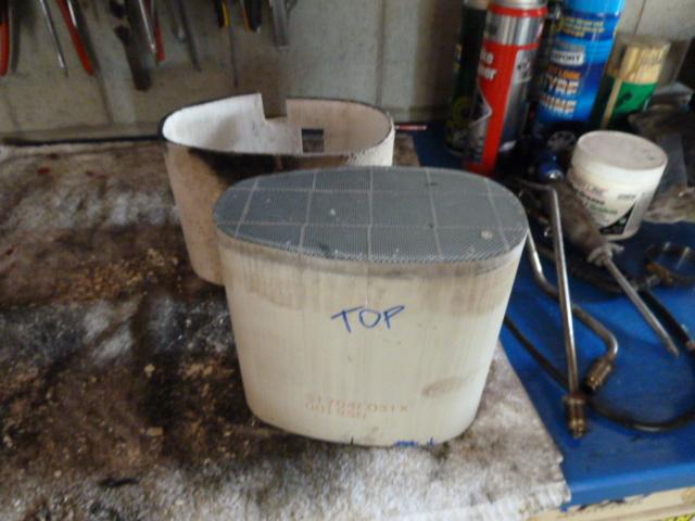

    The core would not pull out like that as it is a snug fit, so I had to open the case further.
    This allowed me to remove the core, and the very delicate heat sheld, which despite your best efforts will likely fall apart. Mine broke into a few pieces by reassembly time, but I put them back in as best I could, this helps keep the heat in during regens, and you want this core to always be as hot as possible. Also very important to mark which side is the top or inlet, as you want to reverse flush the core. There are arrows on the side showing flow, but they are quite faint.

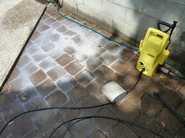

      Well you can go to town with the pressure washer, I had mine right against the core on full power, and no physical damage at all, the core is quite strong. It is however like china and brittle, so if you drop it, you're going to be dealing with pieces! It must remain intact to allow the right pressure difference between the fore and aft pressure sensors, so I took great care not to drop mine!!

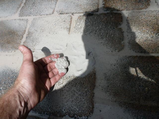

      Here is what came out after a good 15-30mins of blasting up close, holding it with my foot. I got soaked as I sat down to get the water jet perfectly aligned with the long channels in the core. The non regenerable ash is white, and this is what I found the core I smashed up was full of. As you can see from the pics above, I had just finished a regen prior to cutting it open, and there is no black soot to be seen. The black stuff is not the problem!
      An awful lot of what looked like sand came out, much more than I expected, and when you pick it up and rub it between your fingers it indeed feels like ash and rubs down to nothing. It is NOT any part of the physical Silicon Carbide core!
      I washed away the removed ash, and repeated washes till I could get no more white ash out with the pressure washer.

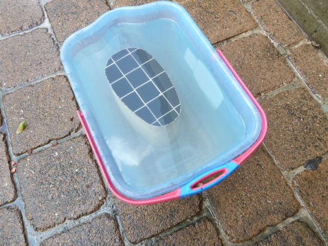

      I then spent a lot more time flushing it over and over in a bucket of water, and found the best method was to lower it in top last, and allow the entering water to "float" the channel contents out each time. This got a fair bit more out, and overall I spent a good two hours washing it out, figured I wanted it as clean as humanly possible. When I got down to very little coming out and the water staying clean, it was time to put it out in the sun, and tee up my brother for some Mig welding.

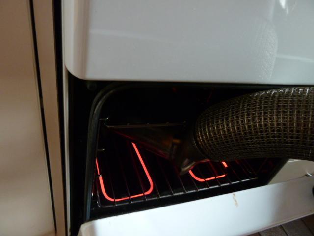

      Putting it back together wasn't too tricky, but we had to wire it together to pull the can back together, as I already had a 1mm blade cut to fill, and the heatshield makes pulling that gap back down quite tricky. Still a few ales and we managed it, and home I went to bake "dinner". I figured an hour in the oven to drive off as much water as possible could only help, I didn't want the car freaking out from too much back pressure with an overly wet core. Probably not essential, just me being careful. A lot of water did indeed pour out the pipe, if I put a glass over the end it quickly showed condensation.
