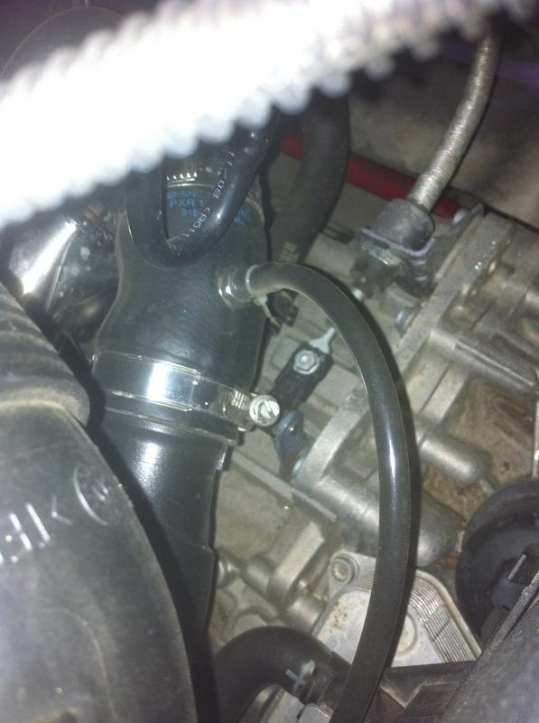

                  Id say they're fairly accurate, the defi units are of a high standard, but as to boost tap location your ideal position should be as close to the manifold as possible.. I doubt there would be any significant difference anyhow

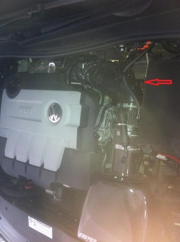

                  This is what the tap looks like after ive put it through the rubber pipe coming off the turbo
                  (you want to mount it on the top side as to not get oil/sludge clogging it up)
                  and this is where that is (under the intake piping)

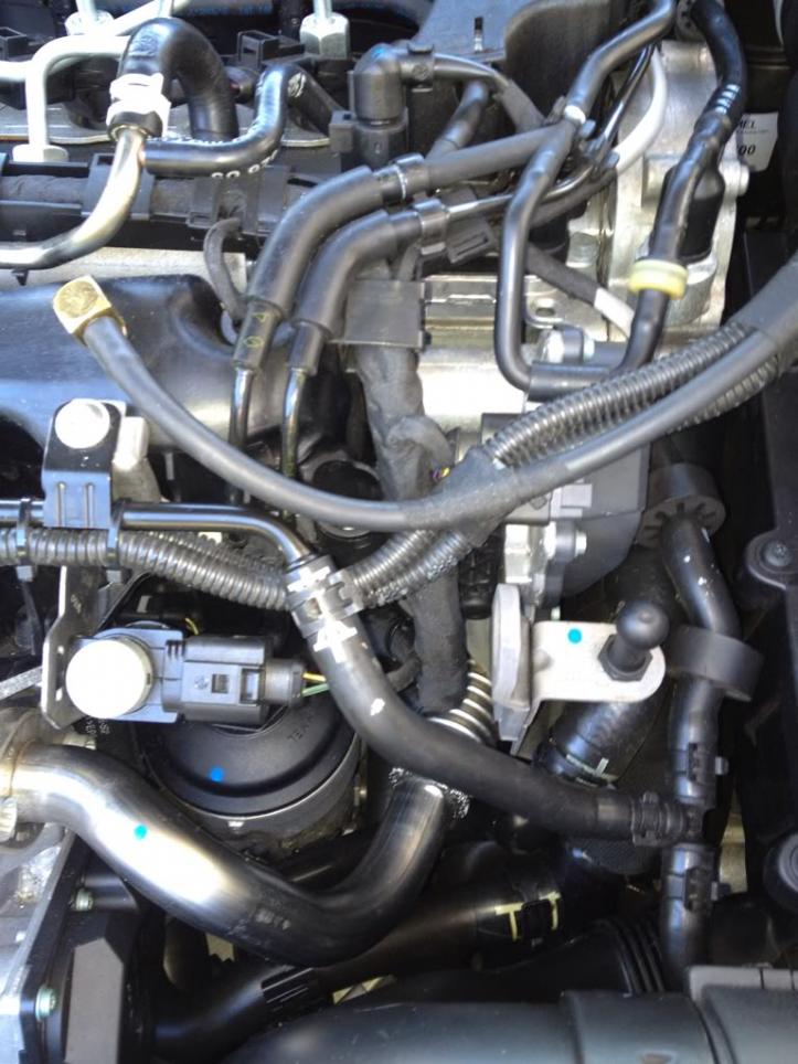

                      125TDI have many differnet parts to the 103 TDI...
                      I have also seen that there are different intake manifolds on 125TDI's.

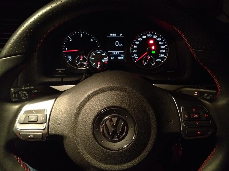

                      I tapped my Manifold for Boost:
                      My Speedhut electronic Boost Gauge and a GTI Seering wheel for the paddles
