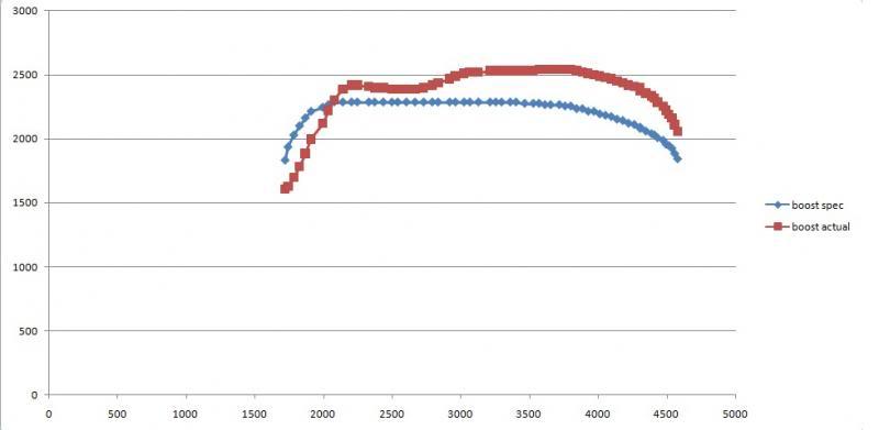

What I'd like to see are the boost logs.

Looks like you've boosted your boost by 10% - I'm guessing the extra air is burning your fuel more completely => less smoke.Resident grumpy old fart
Actually thats something I cant figure out. With the old turbo I was seeing the actual boost line match the spec very well. With the new turbo, the actual is over - why?

The MAP is absolute pressure. So no, its only 22 psi gauge. However, my boost gauge says something like 25 psi peak.Originally posted by Mysticality View PostSounds good.
Is that 2.5bar of boost?
36PSI - impressive!!!
