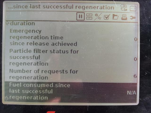

            Bluey, you can monitor DPF with VCDS and some other scaners. It is a good indicator how are the injectors doing and fuel system as well. I use Moreys DSK in our Tiguan since new and am very happy with it. I've changed engine oil 2 days ago (done 15,000km) and checked some DPF data; total numbers of regenaration request - 6.
            The picture is from Snap-on scanner. I know should've use the VCDS but Snap-on resets the service indicator faster and is quick in checking some data as well.
            My wife uses the Tig to drive to work 16km drive one way and to shops 3km and 8km one way.
            Very happy with that result.
            The second Tiguan is my daughter’s ride and she does approx. 6km in the morning and 6km in the afternoon in the centre of Adelaide. Tiguan didn't clock 1,500km yet, but I've already checked the DPF at around 800km and I was very happy what I saw in VCDS. Both cars use Moreys DSK religiously at every fill up. They cary 100ml bottles in the boot and I just refill them when empty.
            In addition to this I aslo use the BG244K once evey 7,500 instead Moreys DSK.
