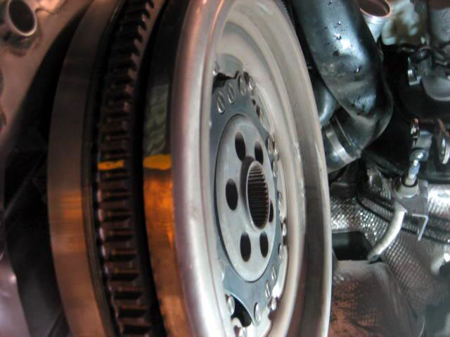

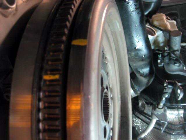

                    Can those in the know have a look at this clip and tell me if there is too much play in the DMF? I suspect my car (the second) definitely has an issue, what about the first?
                    Golf GT Sport TDI

                          It may be on the way out, how many km have you done?
                          Performance Tunes from $850
                          Wrecking RS OCTAVIA 2 Link
                            130,000
