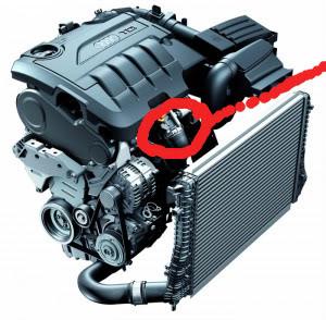

              where is this hose that i need to pull of, is it once of the ones what ill be pulling off to fit a pro vent? on top of the plastic tappet cover ?

                no, i mean a boost hose. easiest one to remove is where it connects to the inlet manifold, it should just be retained by a spring clip that you slide out, then you can pull the end of the rubber hose away from the manifold....
                in the red circle roughly

                  oh yeh i know the one ,
                  I'm changing the oil today so ill have a look
