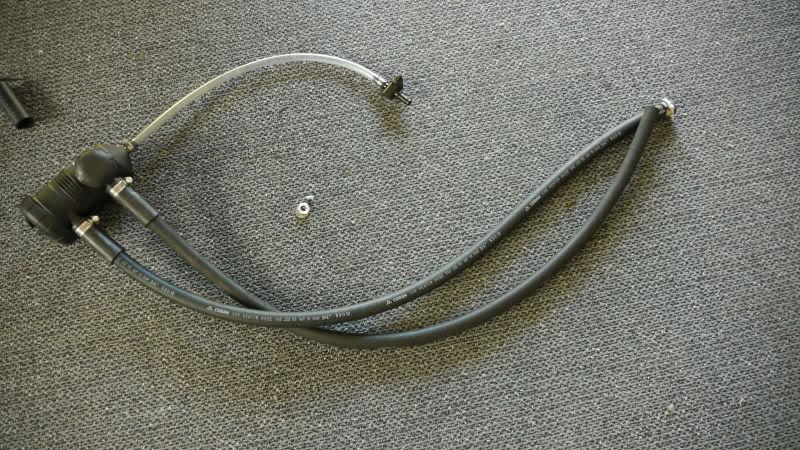

                Sounds like it's worth a try, but the killer is 1" / 25mm hose is just friggen huge, and the beauty of running 3/4" / 19mm is that it flows nicely - the inner dimension is virtually the same as the inner of the Provent inlet / outlet, but it looks a lot more "normal". That's where 3/4" silicon or soft hose is awesome, as it stretches over the 1" barbs on the Provent, you'll blow a valve trying to get 3/4" rubber heater hose over them! A good alternative is 3/4" rubber el cheapo hose with two bits of 1" to adapt for the Provent, and glued or loctite together. See pic below.
