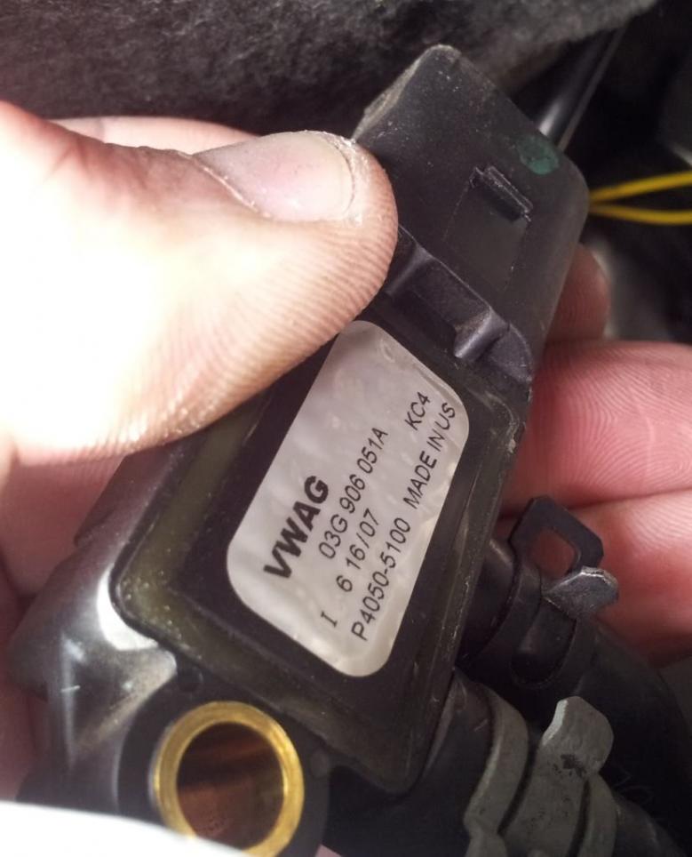

              Bought a new sensor from the dealer this morning, $110
              Old sensor 03G 906 051A
              New sensor 076 906 051A

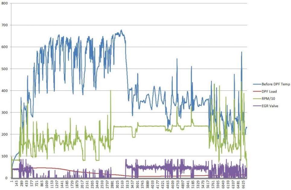

              Good log from 5th August, note the DPF load at about 46% near the start. At 2881 you can see the RPM is constant and the EGR turns off and temp soars. The DPF load then decreases to 7%.
              Bad log from today (faulty sensor still). You can see the DPF load is staying at 20% except for a couple of points where it seems to start working again. Group 070 value 2 seems to be the seconds that the car had been running the regen for. You can see it flattens out when the regen isn't active (DPF mode goes to 0). Not sure what Group 070 value 3 is exactly, its some sort of count. It seems to go up when the regen starts again, but not always. Its now at 4. Maybe the number of times its tried to regenerate or something?

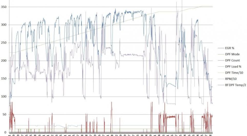

                        Well guys I swapped out the sensor before I left work and entered the new code I found (see new thread) into Coding II and it seems like I am all good. I logged some parameters the whole drive home and it looks good. Soot level dropped from 20% to 5% within minutes and further went down to 0% during the drive home. DPF light went off on dash within minutes too. Failed regen counter went to 0. Started driving perfectly again. I'll post the log tomorrow.
                        My car was doing really funny thing when it was doing forced regens, most noticeably the gear shifts were really wacky. Especially when downshifting, say I was holding 2000 rpm in 5th and downshifted, the revs dropped to about 1500rpm for a second then shot back up to say 3000rpm. Its like the clutch/s was being disengaged for far too long and the rev matching wasn't working. I wonder if it is just because my tune (Superchips Bluefin) doesn't play nice with regens. I certainly wouldn't have been happy if my stock car did that every month or so.
                        Graph after new sensor installed, stupidly didn't log RPM
