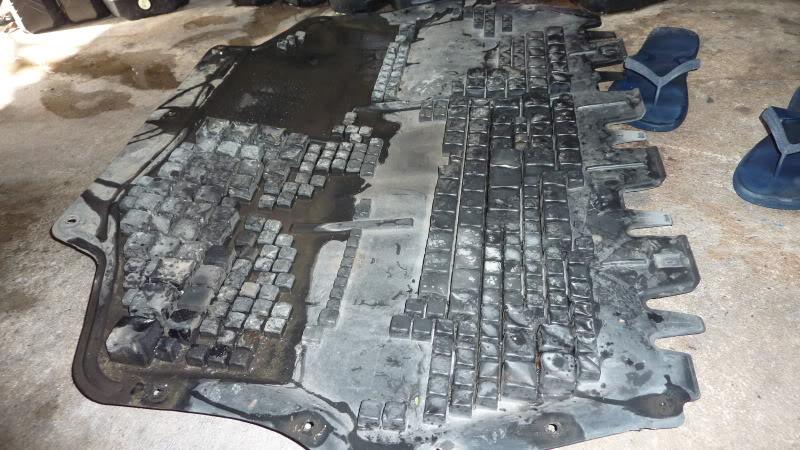

    1) Use torx drivers to remove the smaller screws (4 on each side) holding the plastic undertray to the bodywork.
    2) Support the weight of the undertray and remove the 3 larger torx bolts towards the rear of the tray. Slide the tray rearward so that it is released from the front splitter and remove the tray from under the car.

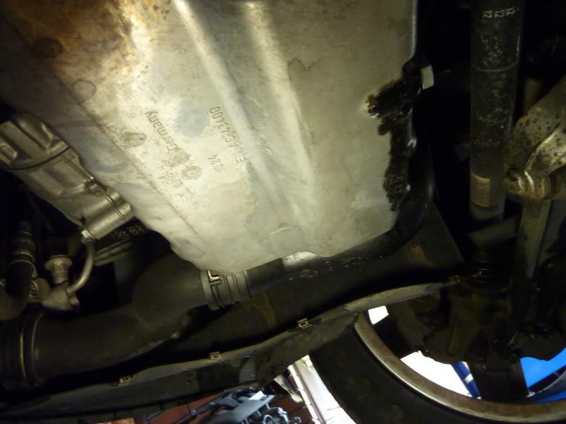

    3) Now we can see the underside of the engine bay and access the oil sump.

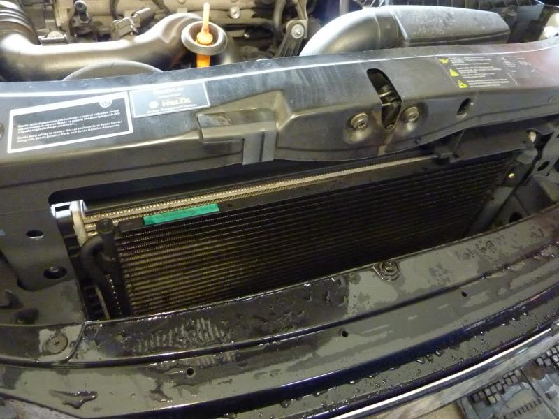

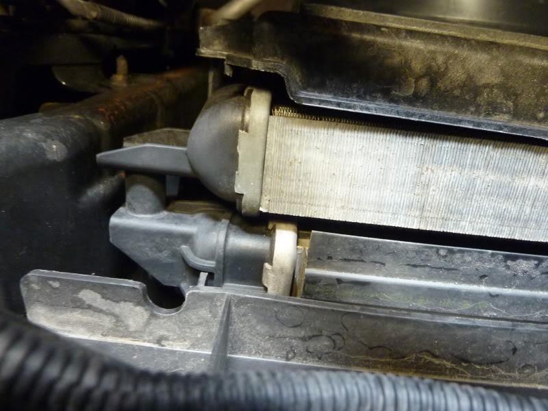

    We can see that the octavia has a front mounted intercooler, which resides in between the radiator and a/c condensor. Its HUGE - and a good thing to, its a pretty big car for this engine, and a tiny turbo!

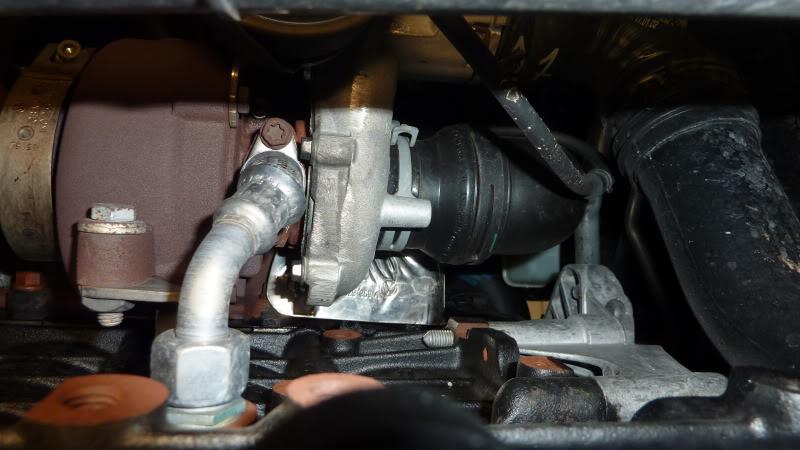

    Heres a pic of the tiny little VNT-15. This turbo really is small, I kinda want it to fail so I can put a proper turbo in there and get some real power.

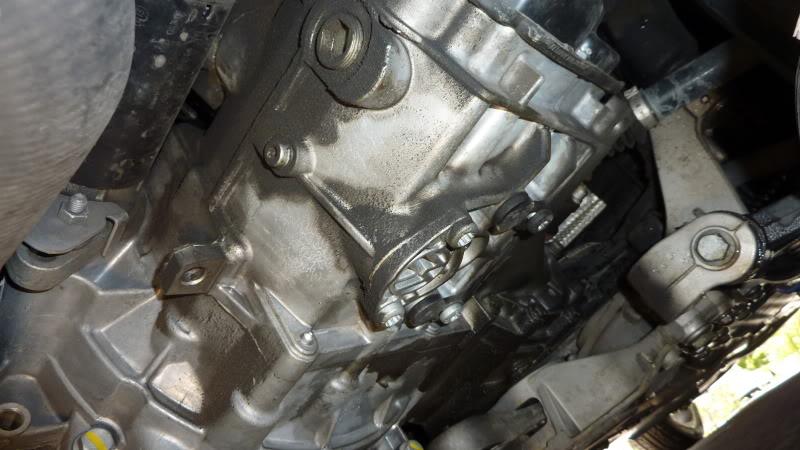

    the O2A gearbox that we know and love - this is actually exactly the same gearbox I had in my mk3

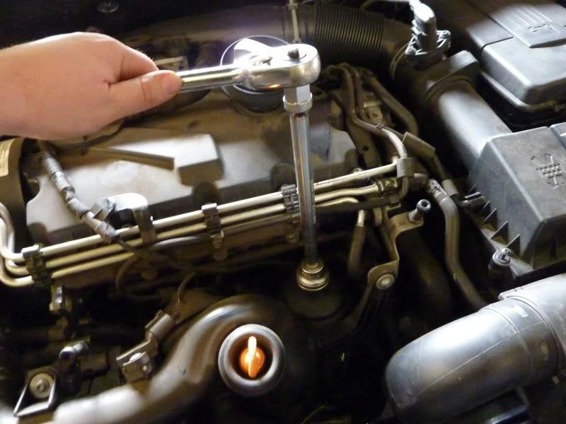

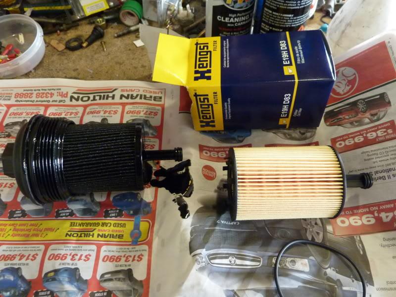

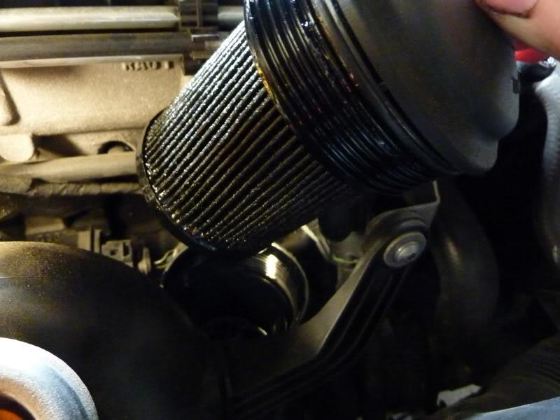

    5) Use a 32mm socket, long extension and ratchet to remove the oil filter housing. Be careful with it, it can be broken if you are too enthusiastic.
    6) Replace the filter with a new one. It just unclips (pulls) out. The new filter will just clip in place.

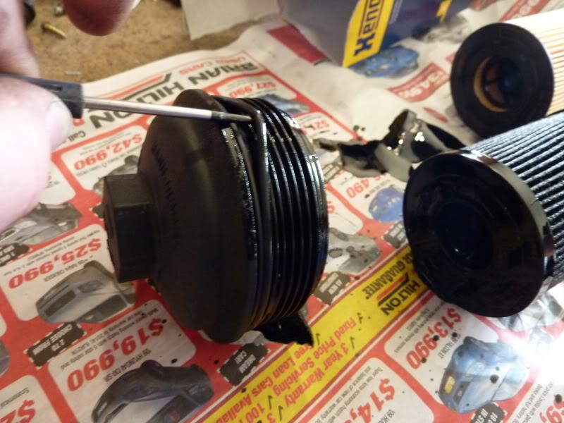

    7) Replace the big O-ring seal. Prise it out with a small, blunt flat bladed screwdriver. Before you put the new one in, lubricate it with some clean engine oil.

    9) Replace the new oil filter and housing. Don't do it up too tight!

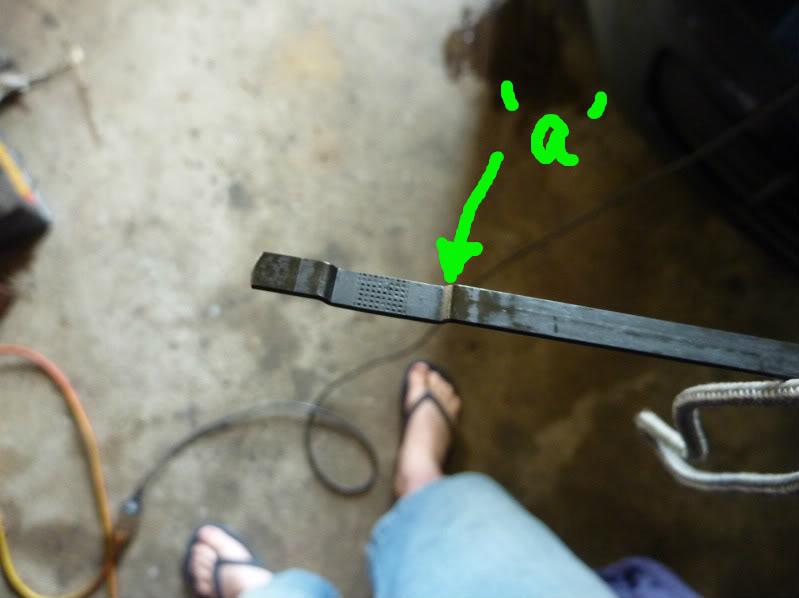

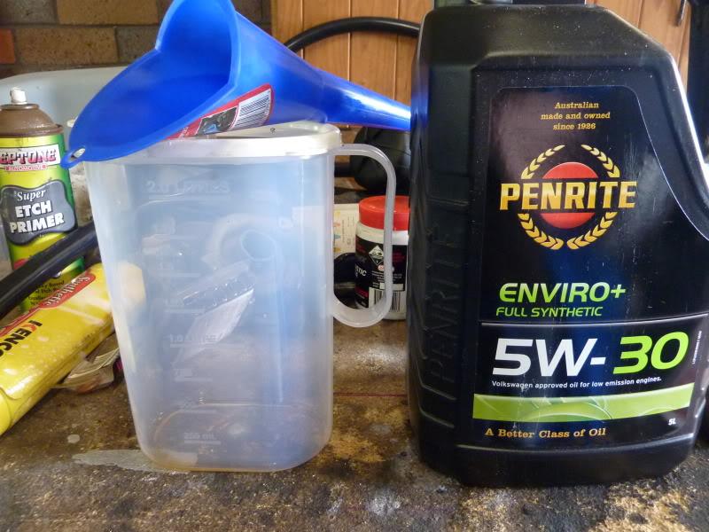

    10) Top up the oil to the mark 'a' as stated in the user manual....use the right oil -
    Enviro+ is Volkswagen Approved oil. I find it easier to fill the oil by first decanting it into a 2L, gradiented jug. This is much easier to pour from and minimises risk of spillage. It should take 4L.

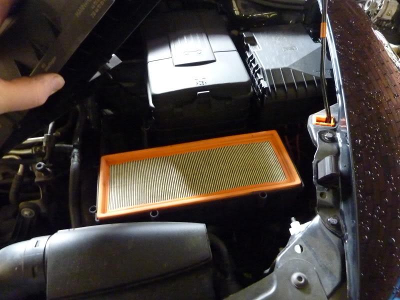

    1) Use a phillips head screwdriver to release the upper airbox cover. Lots of screws, but they are easy to undo...

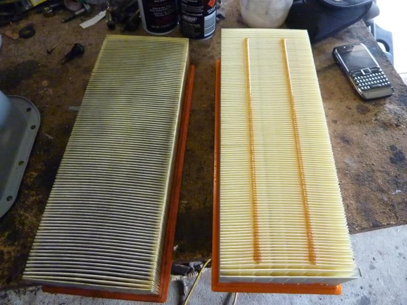

    2) I'm pretty sure the filter had never been changed - a Sydney car, but it just looks OLD. see the discolouration. Not very dusty, but in need of replacement.
    3) Clean any bugs from the bottom of the airbox then replace the air filter, and then the airbox top cover.

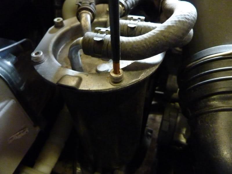

    I was going to change the filter but discovered upon removal of the element that I had been supplied with the wrong part.... anyway, I did determine that mine needs replacing.
    If you just use a torx driver, you can simply remove the 5 screws on the top of the filter housing, and lever the housing out. You need not even remove the hoses from the top. Once the top is removed, its a simple matter of swapping the element inside the housing. Put a rag around to prevent any spillage of diesel into the engine bay....

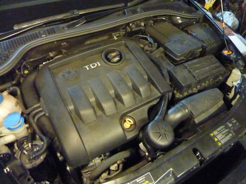

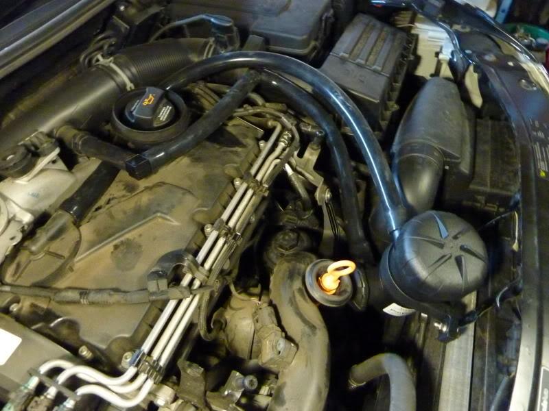

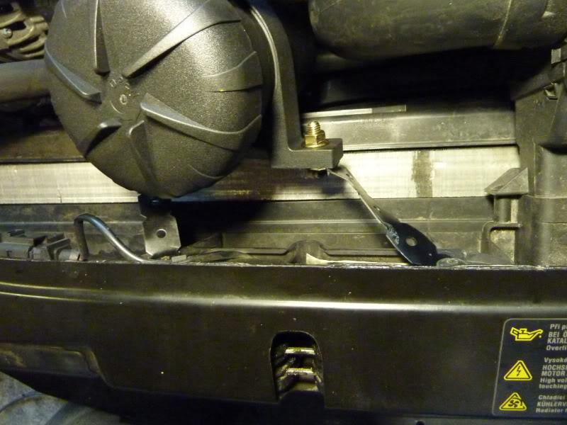

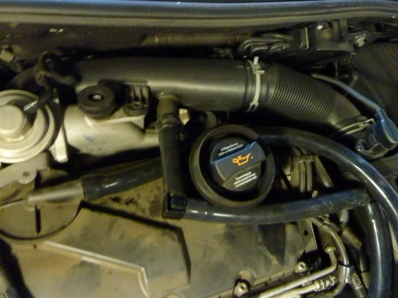

      I decided it would be easiest to stick the provent up the front of the bay near the dipstick.
      I used a couple of bits of "make a bracket" and 2 existing screws in the front upper crossmember.... Its pretty rough actually but I want to make a decent bracket in stainless at work so this will do for now...
      I've used here 19mm black silicone tube. Its pretty stretchy, but a little vaseline on the ends where you are trying to push it onto the 25mm fittings on the provent makes it a lot easier...
      only 2 90 degree elbows needed to rout the "exit" pipe
      ...and a few notches (ok cutouts) made in the engine cover to facilitate the hoses and the provent itself. I did these cutouts with my 5" angle grinder, using a 1mm cutoff wheel to "sideways grind" the plastic away. Its very effective but most people should probably use an abrasive bit on a dremel to do this job...
      Looks almost stock!

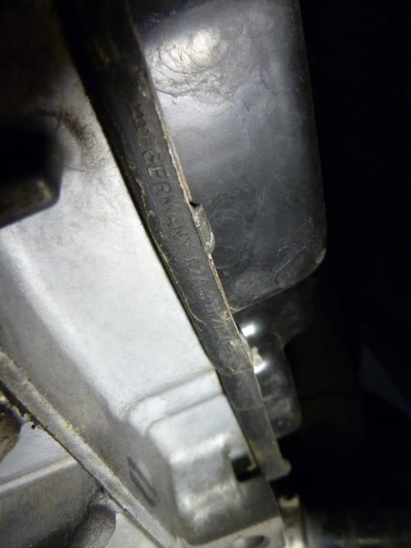

                You may also need to replace the oil filter plug, it is supposed to be replaced at every service to prevent the leakage you have around there.
                The other thing is the turbo may in fact be a KP39, I think most of the later PD100 engines ended up with it rather than the VNT 15 and if that is the case good luck killing it.

                  interesting info about the turbo - thanks!
                  Gave the car a really good run today on the cruise - pushed it quite hard and now the car is going MUCH better. I reckon the vanes were sticking a bit but now its much faster to get on boost, and consequently has the knd of midrange i thought the car should have but didn't.
                  I think the old air filter was pretty bad too!
                  The sump plug/washer looked fine to me, the leakage that was evident around the plug actually was coming from a bit higher up, but I didnt find the source of it.... I would guess its coming from around the valve cover somewhere, but its pretty minor from what was evident on the undertray.

                    I'm happy to see you using the Penrite - thats what I bought and was nervous that it wasn't right.
