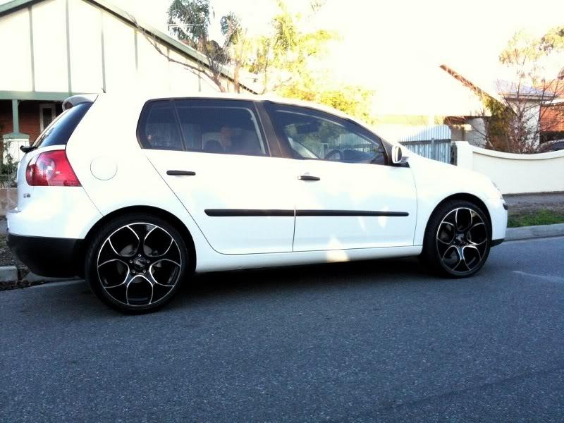

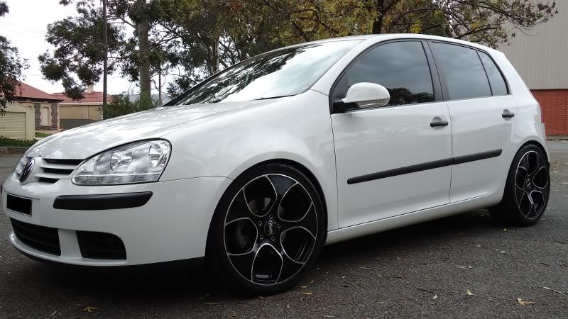

    The car came with the wheels which are 19" Advanti Concepts and 4 brand new tyres on purchase. I was really unsure as to whether i liked or disliked the wheels however I have decided to keep them for the time being. May change my mind later down the track.

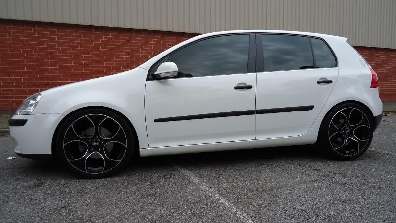

    Next step was to lower the car because it looked absolutely hideous at the height it was at. After countless nights of research i settled on purchasing some H&R Race Springs (50mm drop) just as another member on this forum did (Poyta) for his GT.
    Ride is quite a bit firmer but the look and stance of the car is now fantastic.
    Much Better

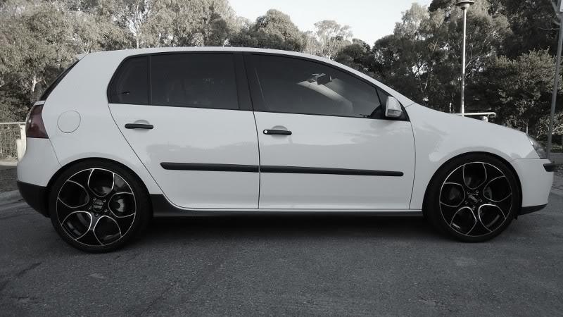

            Wasn't really happy with the side profile of the car, seemed really rounded so I quickly decided to put on some GTI side skirts to give the car a more aggressive appearance.
            2007 Golf MKV 2.0 TDI DSG
            | CustomCode Phase1 ECU + DSG | aFe Stage 2 | SprintBooster | KW Variant 3 | 19" Breyton GTS-R | GTI Side Skirts | GTI Front Bar | GTI Shifter
              Sounds familiar Although I left my skirts the textured black finish I think in your case on a white car they should be painted to colour code. The black texture works on my car because my car is black but on your white car they really stand out. Just an opinion.
              Maybe while you're at it colour code the rear bar ( you can have my old one if you want ), side and front protective strips and the door handles.
              2007 Black Magic VW Golf GT TDi, Latte Leather, Sunroof, Bluefin Superchip, 18" Detroits, APR lower torque arm insert, APR Carbon Fibre Cold Air Intake system, GTi sideskirts & front lip, R32 Rear Bar, GTi Steering wheel, RNS-510,Infinity BassLink Subwoofer,stubby antenna, R8 Oil Cap, Golf R front calipers, slotted front rotors, ceramic brake pads, LITEC LED tail-lights, Dension Gateway Five, Rear Emblem Reverse Camera, H&R Ultralow coil-overs, Badge-less front grille
                Thanks for your offer and comments Poyta. I'm actually liking the contrast in colours and the theme of my car is black and white. I guess its a matter of personal opinion/taste but at the moment i'm really enjoying all the textured bits. I had this look on my STi also with the side skirts and rear canards. Looks quite race.

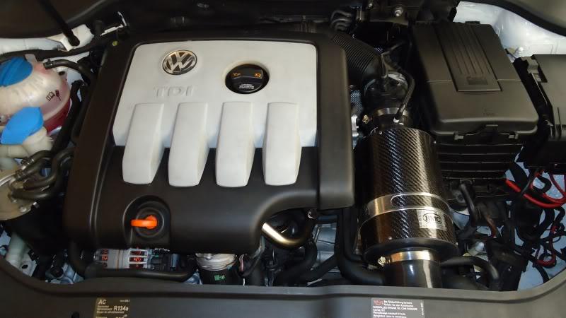

                            Now for some wank factor....

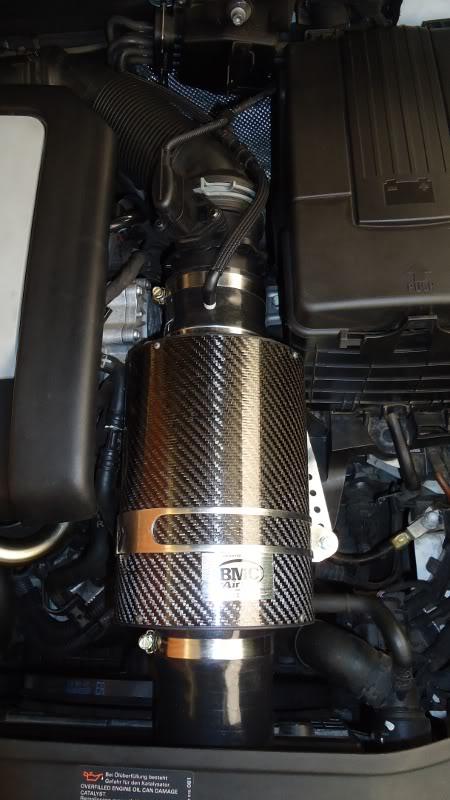

                            I was intending on going down the APR path with their carbon induction system like so many others have done, however I had completely forgotten that I had a BMC CDA (Carbon Dynamic Airbox) laying around which I had taken out of my Liberty when I first purchased it.
                            The BMC CDA is very similar to the modshack in design but has the added bonus of some carbon goodness. Also it's worth twice the price of the modshack and roughly the same price as the APR intake.
                            Performance gains? Probably nothing gained however there is an increase in the induction noise and also the wastegate is now more audible. Some people have noticed turbo spooling earlier but I can't really say that I've noticed this at all.
                            Street Cred? Definitely looks the part in the engine bay. +++
                            Installation? Install was quite straight forward. Obviously the stock airbox had to be completely removed. The only modification you need is to drill a hole for the vacuum hose in between the MAF and intake and stick an irrigation spike into the piece of hose. This unit comes with a mounting bracket, so you will need to find a suitable position to attach it to. I opted to use one of the mount points from where the standard airbox was attached.
                              Cool, did you manage to get a nice seal between that rubber hose in front of the airbox and the air-inlet in the grille? I seem to recall that Greg had to make something up for that which he did with Carbon Fibre.
