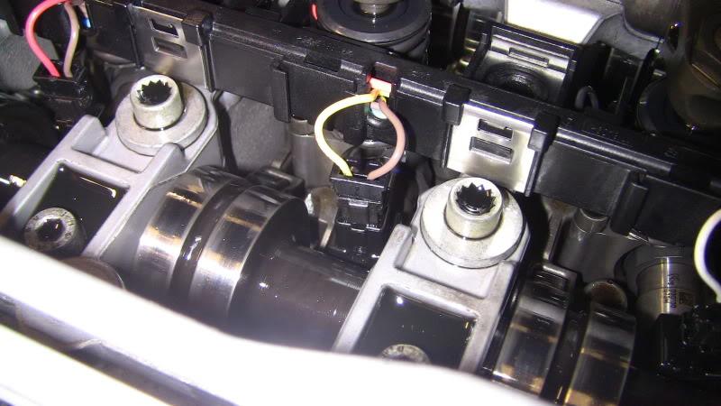

                              I have 03G 130 073M injectors ( can just read on the bottom right of pic ), so it seems sooner or later my TDI will probably conk out...but it will be interesting to see if my heavily modified TDI is still covered by the above....
