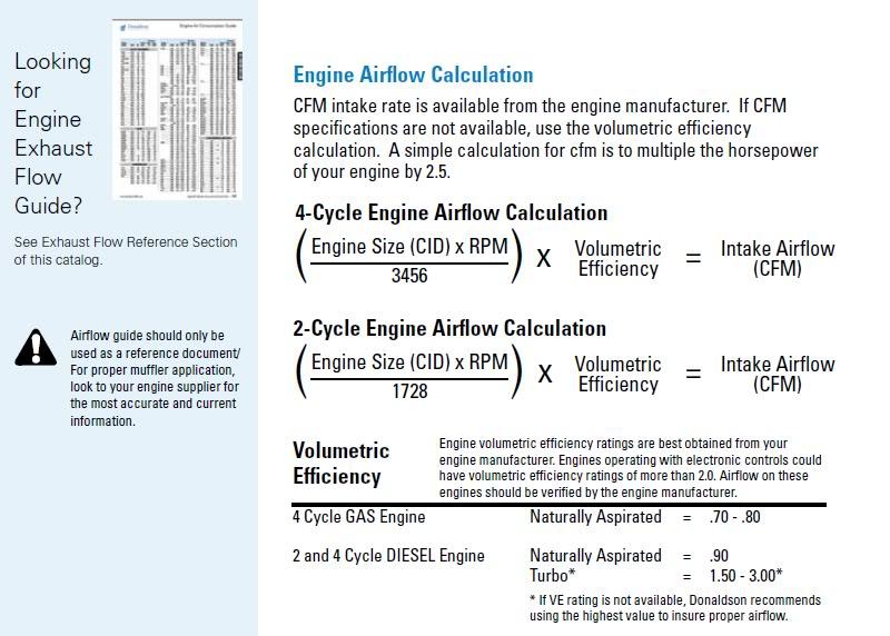

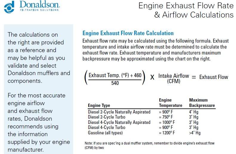

Now about all I can find anywhere diesel specific is truck information. Donaldson.com has some great info, and below are the screen captures of their CFM calculation for intake and exhaust flows. Using them with max values at 4500rpm, I get about 500CFM intake and towards 1200CFM exhaust! That seems nuts even to me! For sure it's "ideal' has no bends, muffs etc, but I'm after a figure of some sort! If indeed my TDi can flow about 1000CFM at max RPM, what sort of pipe diameter is ideal for Golf length? I'm aware there's too big, just as there is too small.
Basically I'm wondering if the stock GT TDI system at 2.5" for 170hp will be way too small at 250hp plus. Seems likely. I'm thinking 3" which has a much bigger cross section. Again, don't bother telling me what Skylines etc use, I have done a lot of reading in the turbo scene there, but it's a totally different kettle of fish.
