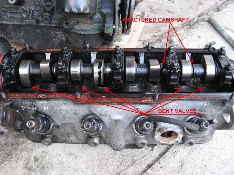

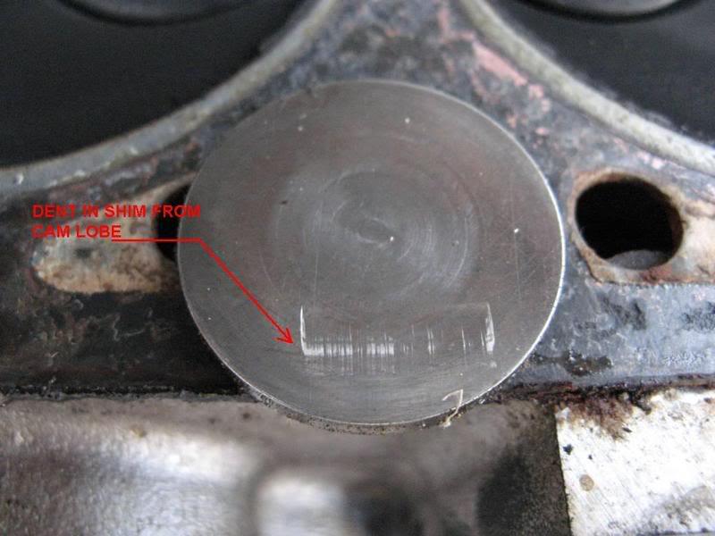

      And finally...
      The Shim.....
      The head....
      Let this be a warning to you....
