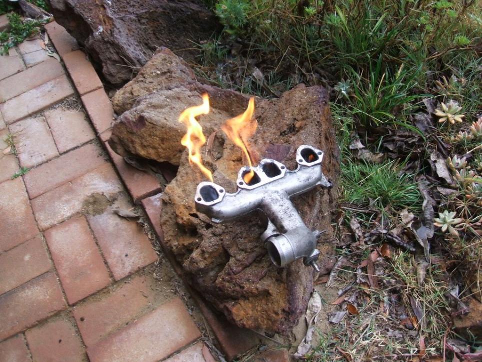

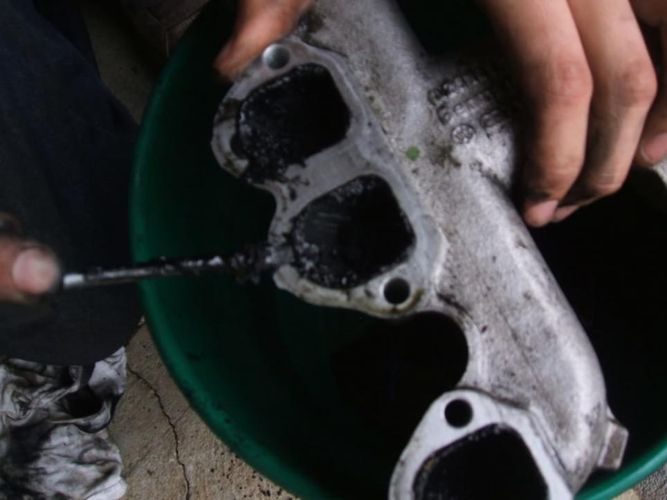

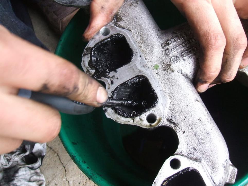

    I tried to clean out my intake manifold (pictured above) with a screwdriver, but i got tired of that. So i decided it would be much more fun to burn it off!!
    so we did
    this got rid of the oily sludge and left just flaky carbon cakes. This just flaked off and fell out when I tapped the manifold on the ground.

            this is one way to clean the buildup a bit quicker?
            http://www.youtube.com/watch?v=oet4q...eature=related
              would have used an air compressor, except we didnt have one handy! we just blew in the inlet pipe until we were dizzy
