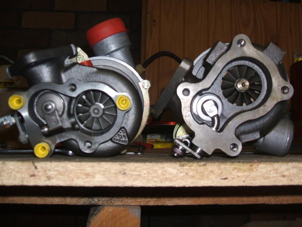

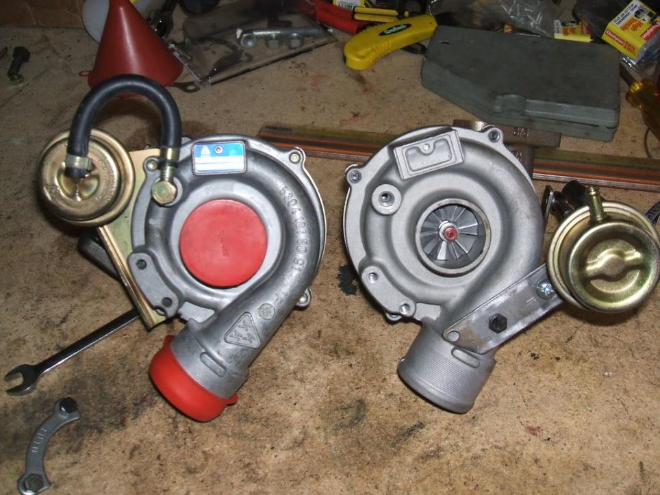

ok.. so the story is.. i have a chinese turbo. its a K04 copy made by the reputable manufacturer "YEQI". Definitely my favourite brand!
anyways, its crap. So.. Aydan found a real K04 on the net for 300 bucks. so i bought it. Its a genuine 3K K04-003 from a chrysler 2.5.

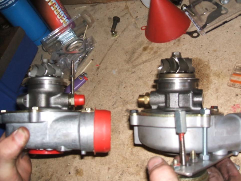

here are the two turbos side by side

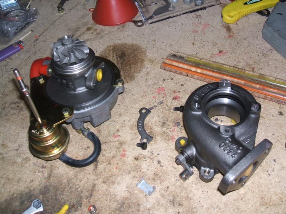

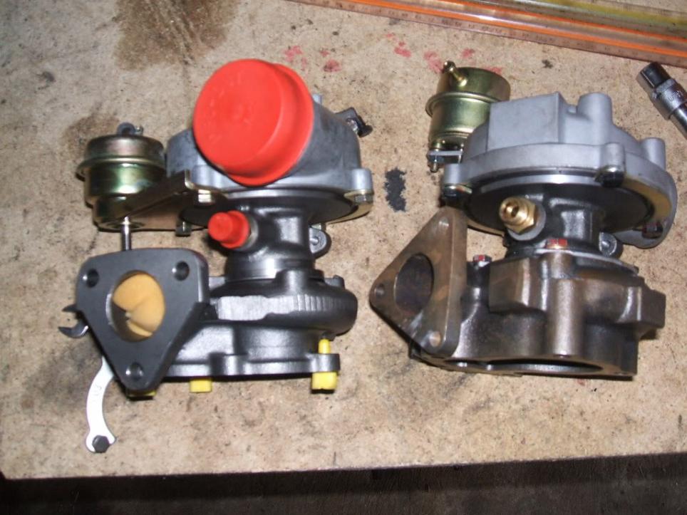

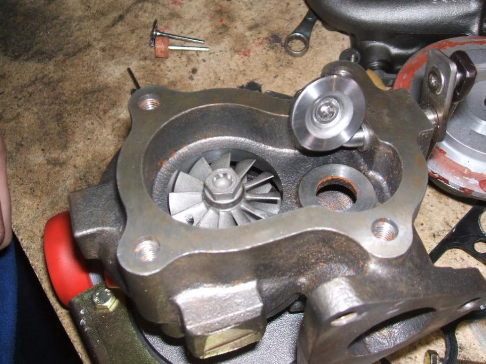

the problem is, that the turbine inlet on the new turbo doesnt match my exhaust manifold. so... we pulled off the turbine housings to see what we could see
here they are again side by side
They looked pretty similar, so all we had to do was swap the turbine housings!!
almost..

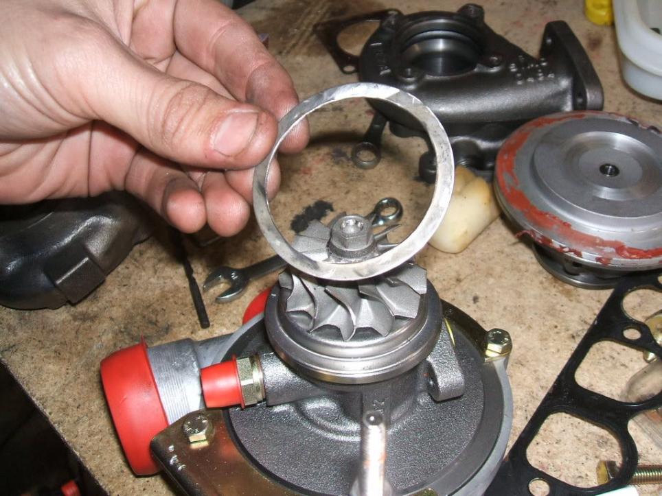

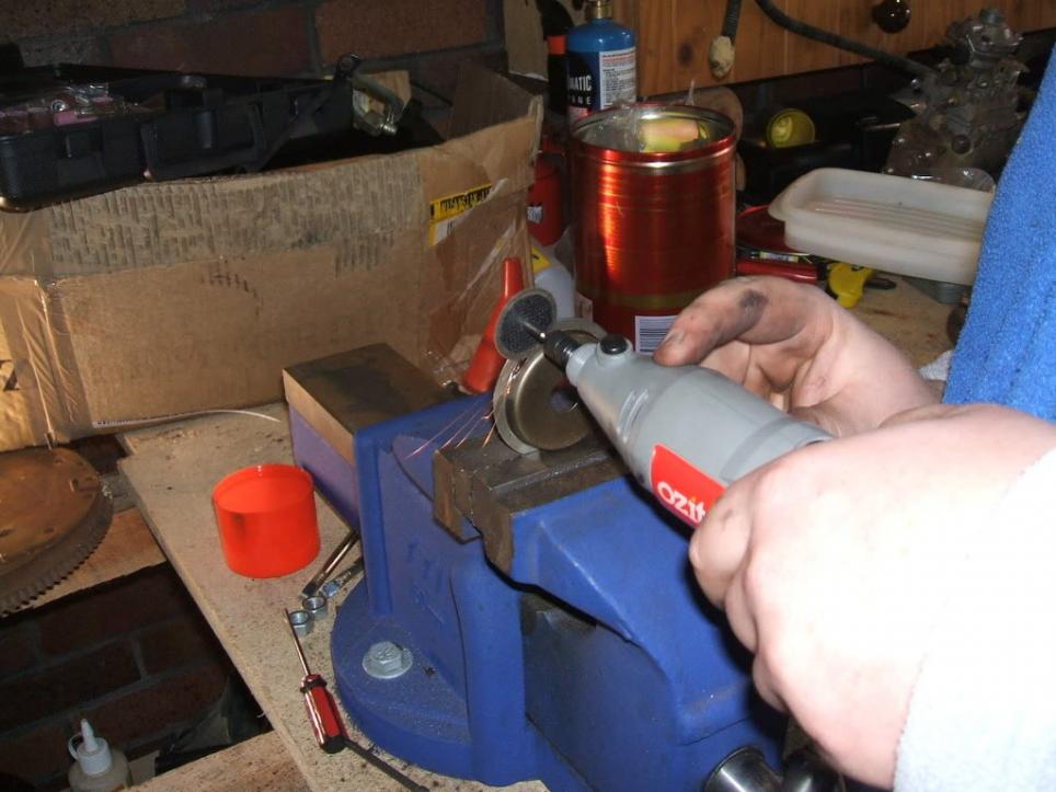

the problem was that the turbine blades were just a smidgen taller at the outer diameter on the 3K turbo, which meant the blades contacted the casing from the YEQI. so... we used the backing plate from the YEQI.. with a bit of modification:
we got this!
which when placed under the turbine housing, gave the perfect clearance for the turbine wheel!

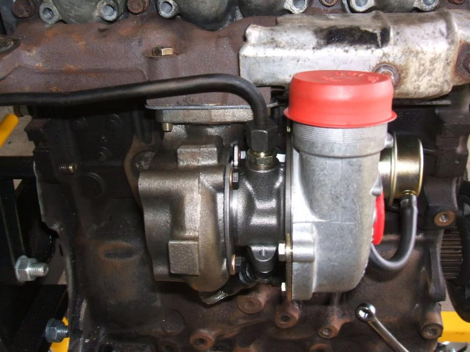

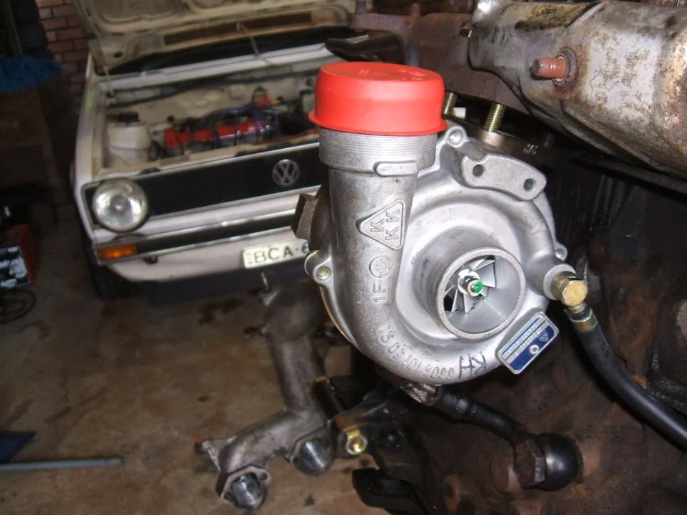

a quick test fit:

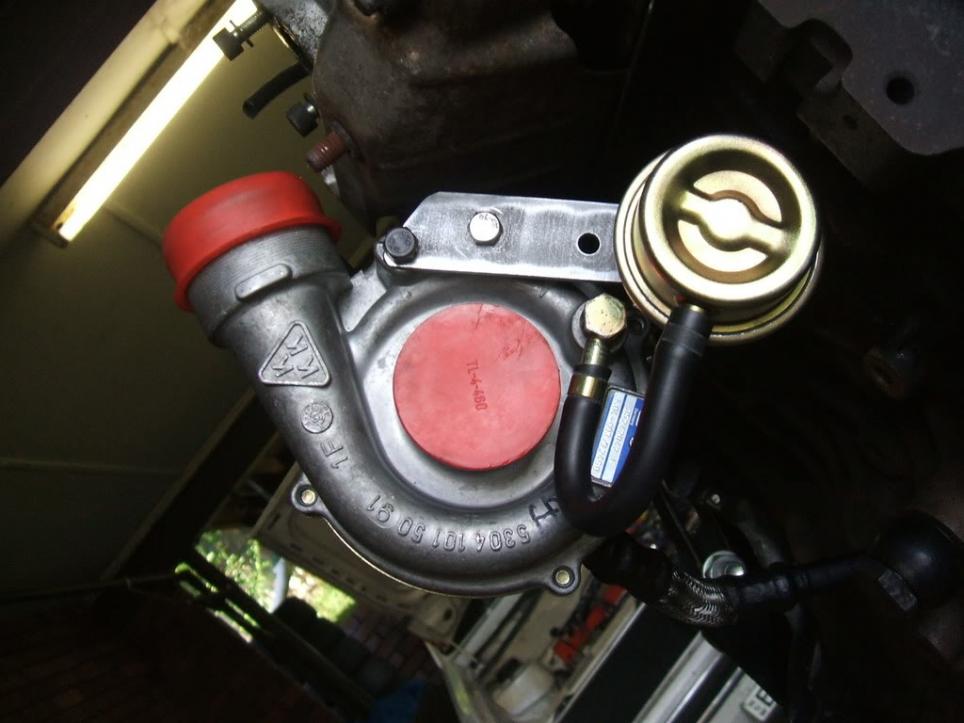

then to mount the wastegate actuator. had to tap some holes on the 3K turbo. then:
nice one mate, as Jarred said i hope that housing is good quality
you guys are the ultimate DIY's!!

admittedly, there is no exper(ience)tise to be had here... but both of us are mechanical engineers, and both of us agreed that there should be no reason for anything bad to happen.
