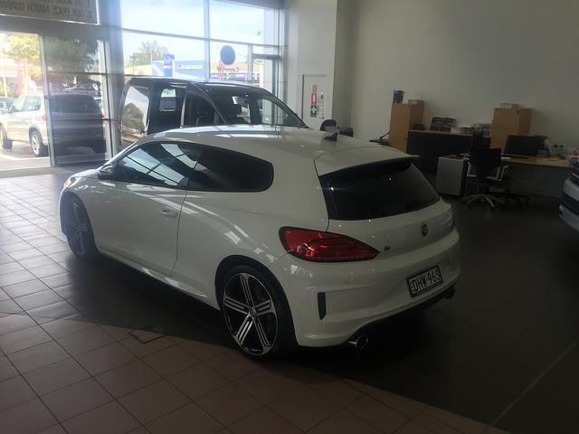

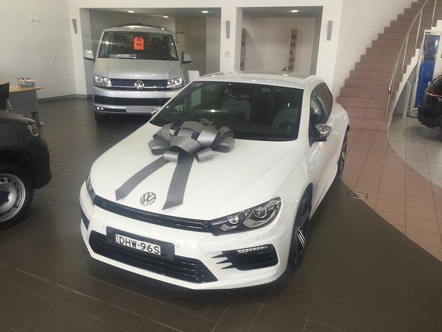

    I found a car in the colour that I wanted and went and looked at it. I fell in love and did the deal. A few days later I received a phone call telling me that my car was ready to be picked up. I rolled up to the dealership and hour before they opened because I was rather excited.

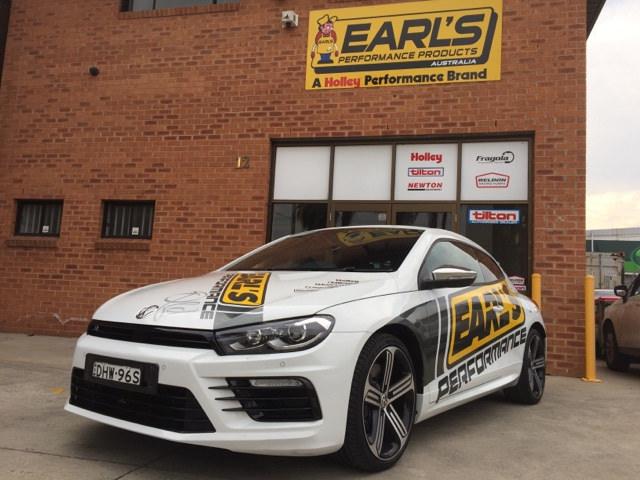

    This is how she looked when I picked her up.

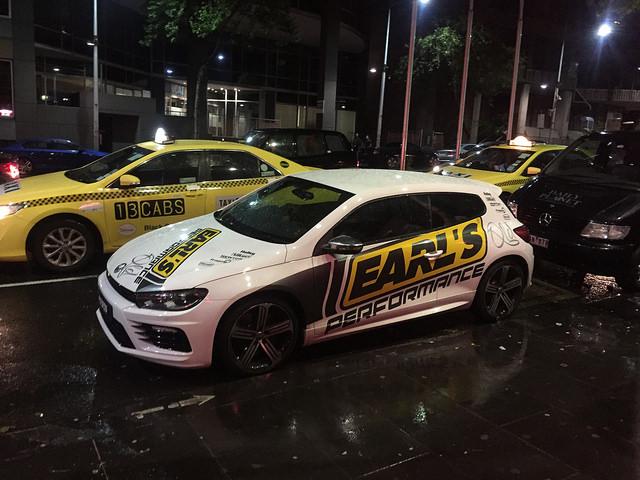

    It was decided that some signwriting was needed.

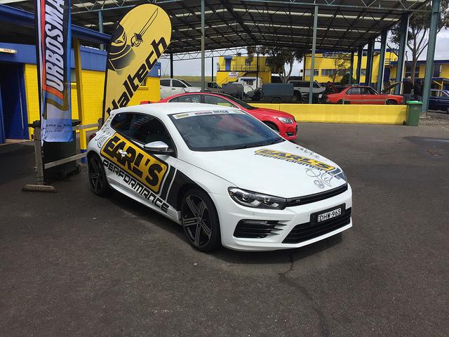

    As we were a major sponsor for the Street Machine Drag Challenge we decided to pack our bags and make the trip to Melbourne.

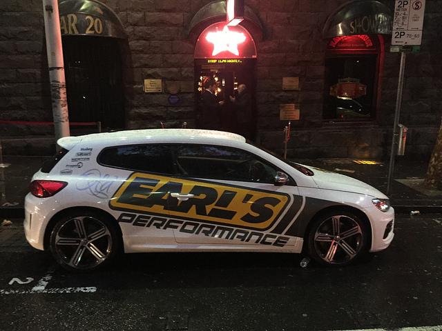

    And of course needed to go for a cruise.

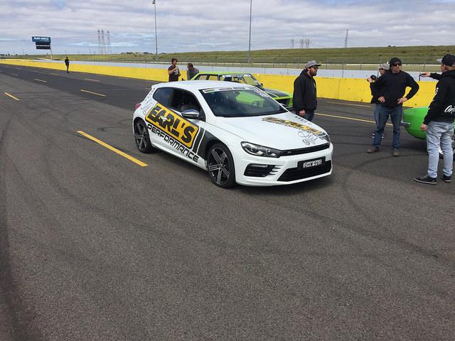

    We ran the car down the quarter mile and found a major issue even in a standard car. Wheelspin. No matter how the car left the line it just tramped and spun the whole track. We set a time of 13.856 @104 mph but just couldn't get traction.

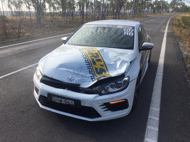

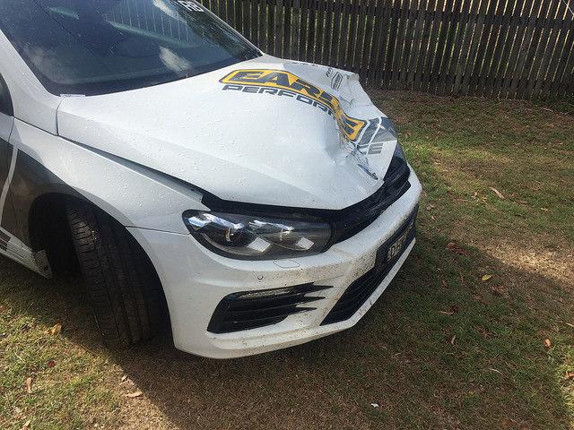

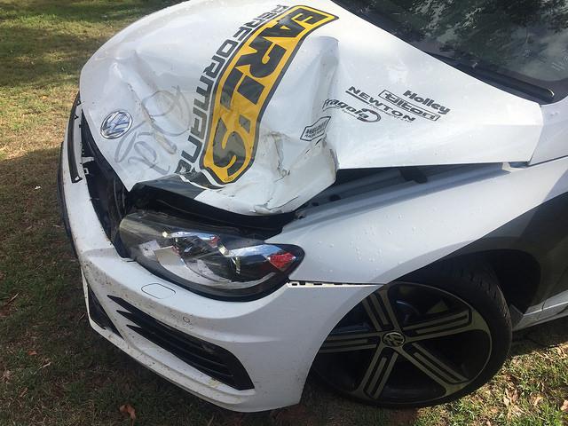

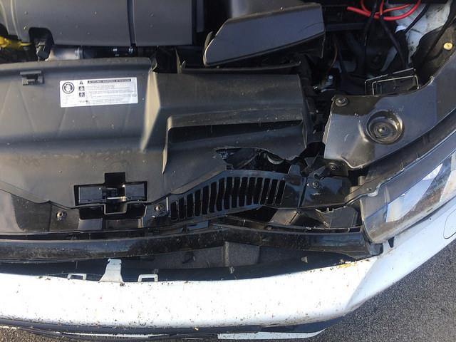

    While travelling at 110km/h a kangaroo decided that it wanted to have a rest on the front end of the car. I managed to slow to approx 60km/h at the time of impact.
    I was lucky in the sense that the radiator remained intact and didn't leak so that I could limp the final 600km home. The intercooler had a broken end tank and the condensor had spilt its love juice all over the ground.

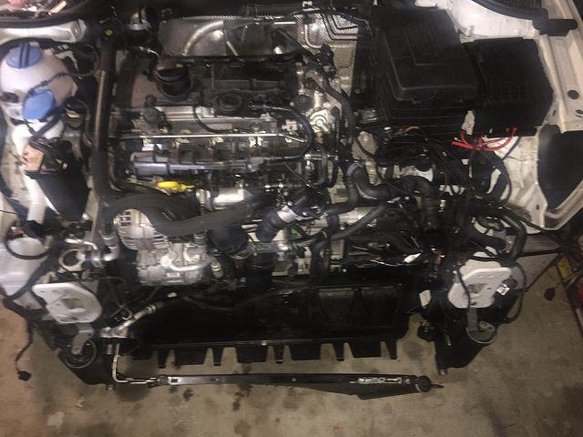

    So this leaves me at where we are today. Progress will be a little slow to start as the car still needs repair before the fun stuff can start but here is what the car looks like today.
    Let the fun begin............
    Ready for an epic adventure...........................
