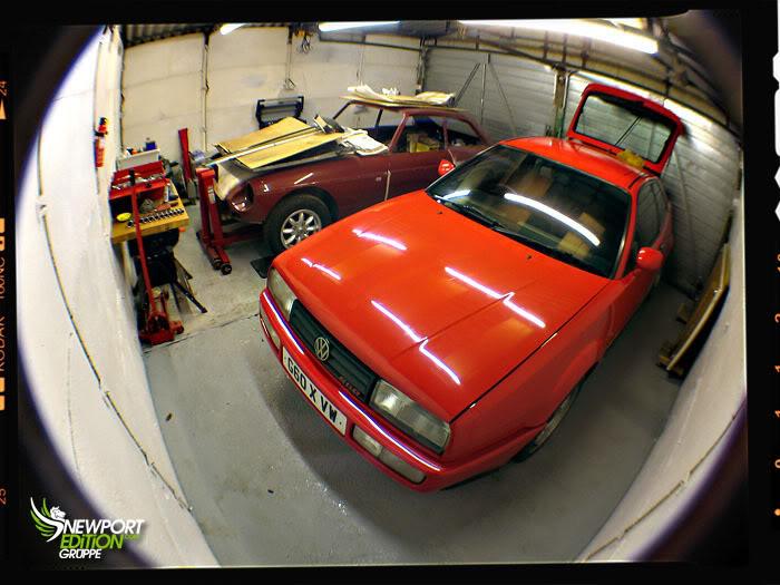

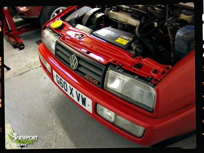

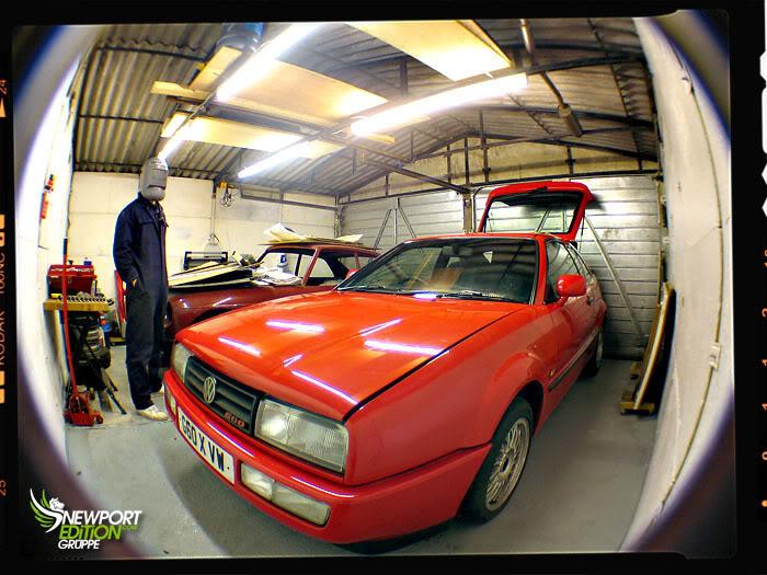

        Anyways.. spent the last few months getting the new garage sorted. Lick of paint, sorted the leeks out and security issues.. so finally started to pull the charger apart to see what the damage was.
        New garage.. secret location

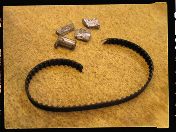

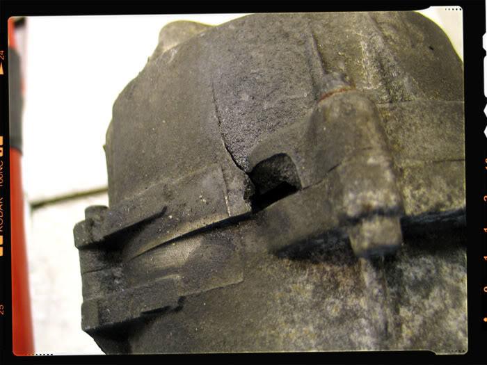

        Blown charger:
        Found this on the underside.. it had also blown a hole in the main chamber:
        Found out what happened soon as I removed it.. looks like the toothed belt just failed and caused havoc inside.. I see why G-werks use 12mm belts!
        G-lader owners check your belts NOW!

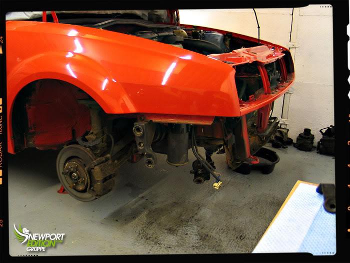

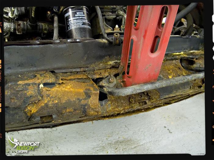

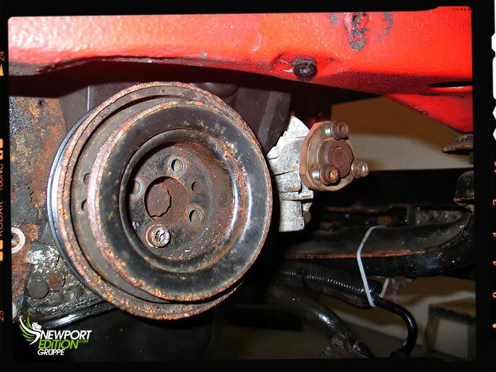

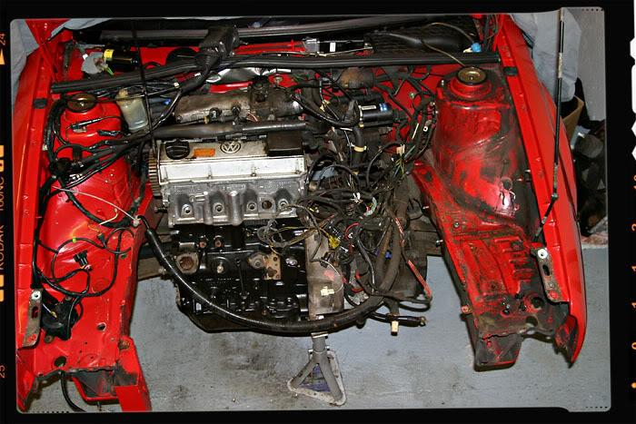

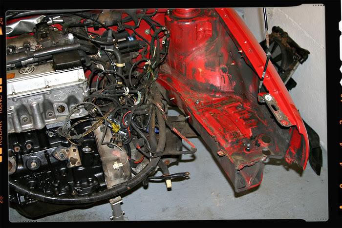

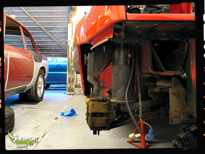

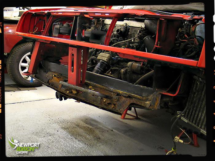

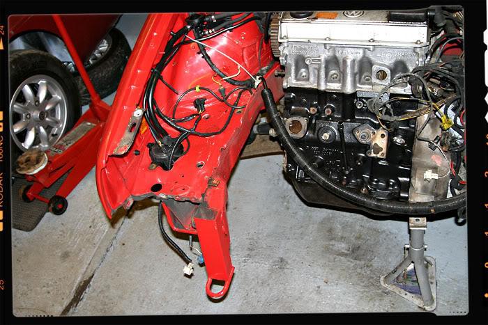

            Charger, brackets, rad and everything else forward of the engine block is out. I only meant to swap the friggin charger out?! But you know how these things end up.. "I'll just clean this.. then that.. ohh there's some rust there.." oh crap!

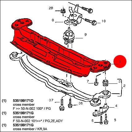

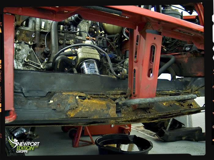

            After pulling the bumper, I can't believe what I found?? I guess being parked up in a damp garage for a year has done it no good. The rad support or cross member has completely rusted through. Basically I need a new one, or second hand and restore it. It's too far gone to fix.
            According to ETKA there's two types, early and late. I'll need to check my chassis number...
            It's this bit:
            I hate this bolt!!! Rounded out completely.. The only one that defied the air impact wrench! Should be fun getting this out..

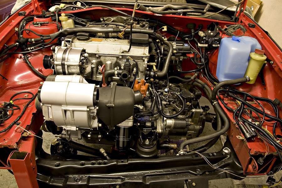

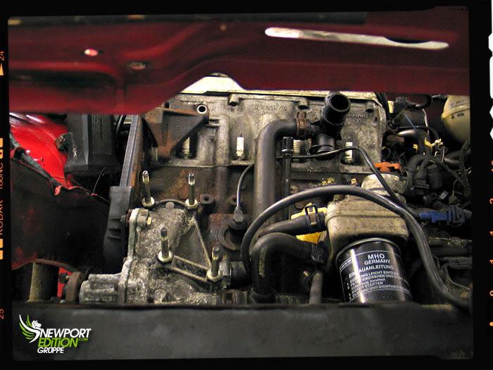

              Not much to update other than 3 weekends worth of solid cleaning, scrapping and painting.
              Then there's the endless task of listing all the seals and gaskets I need. Not to mention rounded off or snapped bolts!
              Just started to detail the other side of the engine bay.
              Next job is sorting all the wiring out.. well.. replacing all the cloth tape that has perished over the years.

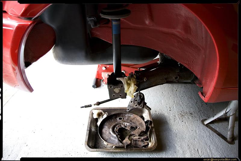

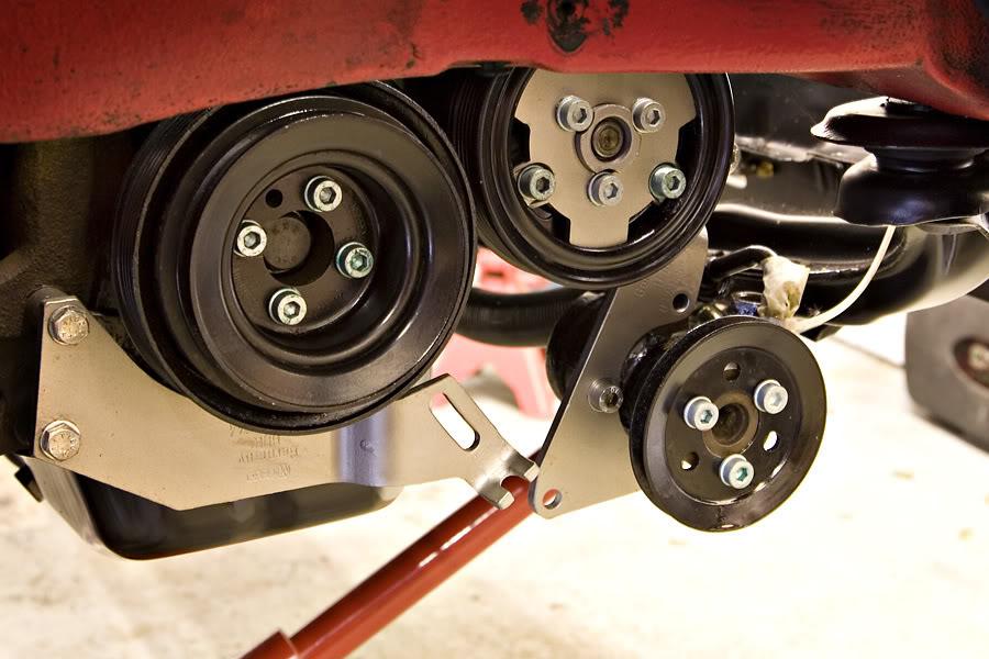

                Finally got the brackets and charger back from G-Werks, fitted them last weekend. All the refurbed pulleys are back on and torqued up, and all the front suspension has been overhauled with new wishbones, bushes, balljoints etc..

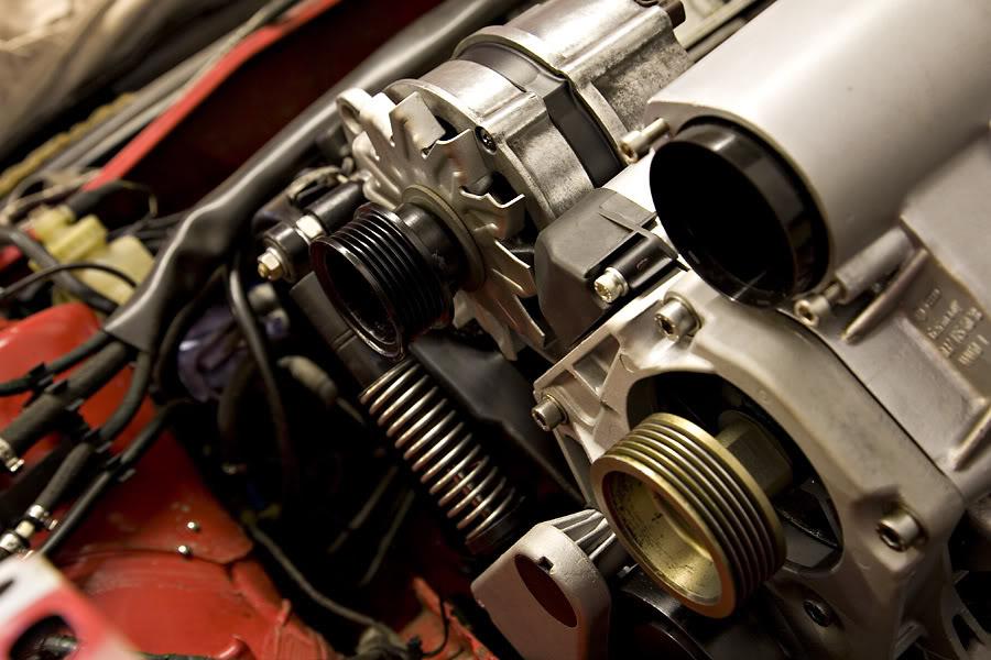

                Shiney pulleys which no one will ever see..
                Cleaned up alternator and another pulley (shiney stainless bolts)..
                New charger and brackets..
                What a mess.. I hate the 8v engine bay..
                Close up of the most stupidly expensive thing ever (£400 to have G on the side?!)..

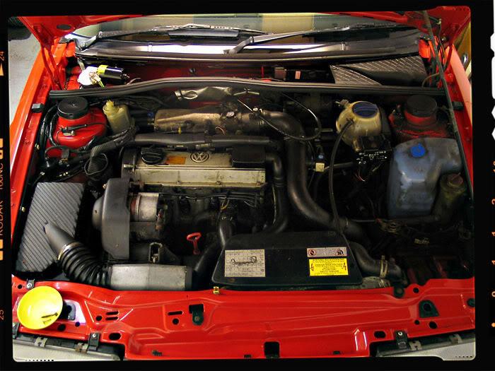

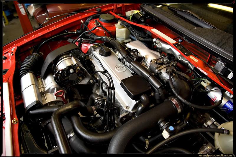

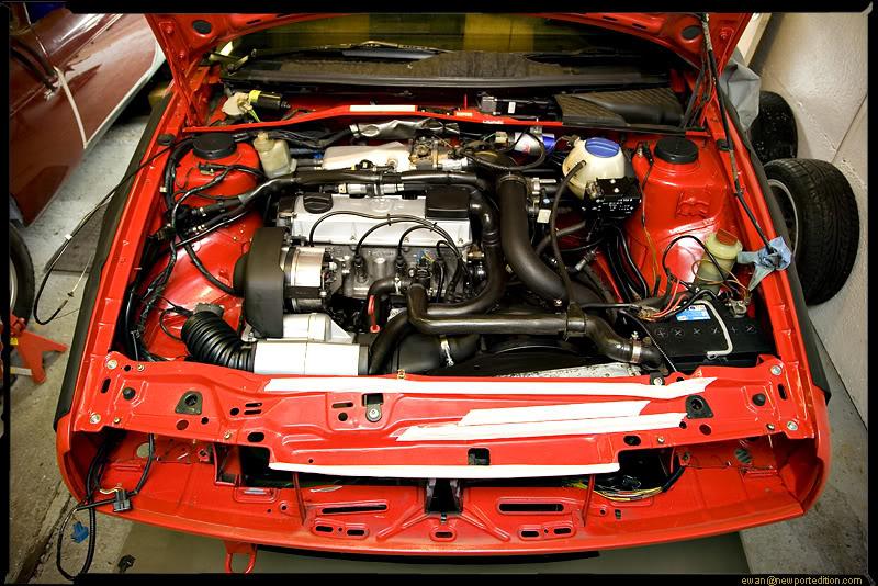

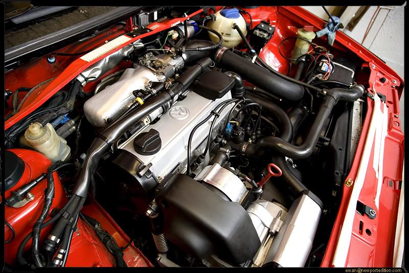

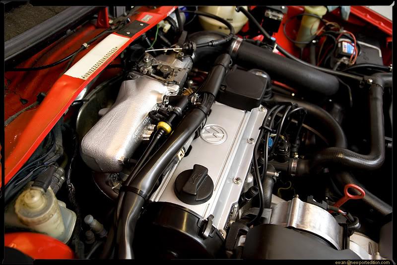

                    With all the parts finally in front of me I quit cleaning stuff and made a big leap forward last weekend to get it running. I'm just waiting on one intercooler bracket now from G-werks, they lost the one I left them so they've ordered a new one from vag.. one less bracket I have to strip and paint anyway. :up:
                    After triple checking every pipe and most bolts I filled it with liquids and gave it a go. Took a few attempts to get going, timing was out at the dizzy and I hadn't plugged in the alarm. Luckily I decided not to rip out the original alarm loom before start up, I'll need to pull all that out and replace it with a new one as the remote fob and key have gone missing at some point.
                    It runs though! Albeit a tad lumpy and the idle is all over the place.. a few hours reading the Bentley and scouring the forums for fault finding write ups and fingers crossed it'll be good enough for a trip down to G-Werks for a final tweek.
                    I think the alternator has seen better days after being stored so long, if anything at all it's reading near zero on the ammeter.. so thats another 100 bucks I haven't got.. brilliant.
                    The charger is loud as a mo fo without the airbox installed, whistling and whining like something annoying.. love it!
                    Just the back shocks, brakes and bearings before being mobile again after over a year in storage.. even German cars don't like sitting doing nothing half their life. When I'm happy it's running ok it'll be back in the garage for an interior strip and major paint detail. The back seat still has a big rip in it, the stereo is none existent and the old alarm needs replacing properly. Besides, the interior needs a good scrub and taking it all out is the only way really.. just seats, carpet and door cards though.
                    Hopefully this will be the last update before getting it back on the road!
                    Some pix...

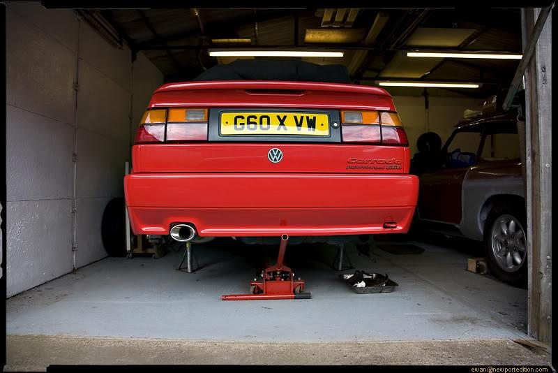

                    Arse shots:
                    Lets hope it stays this way for a few more years..

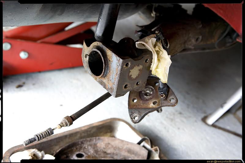

                    Rear axle overhaul..
