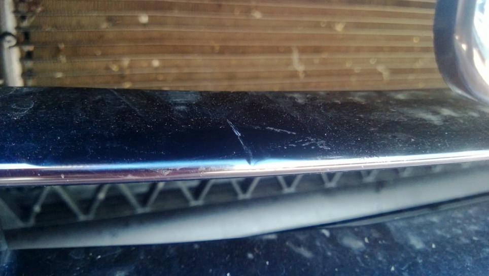

                  Where the dealer believes the projectile came through

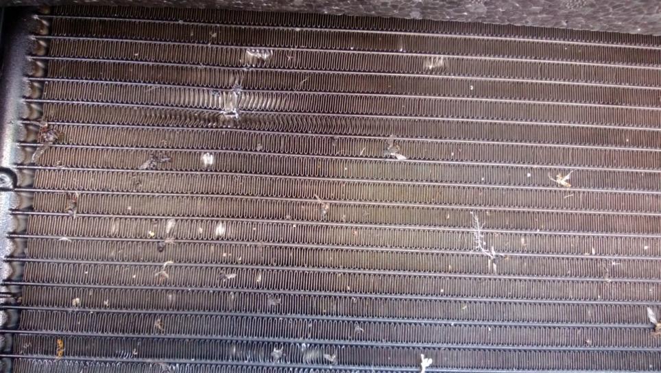

                  Where the condenser is damaged
                    yeah it's fairly hammered and I can see at least one tube is split which would have released the refrigerant thus making the AC just a warm fan....
                    the total repair cost seems about right for a new genuine condenser at dealership prices along with remove/replace, re-gas etc. it's a bitter pill but you might be best to just swallow it and move on.
                      indeed. though its doesn't help looking up the parts prices..$250 all up. The rest must be labour and gas?
