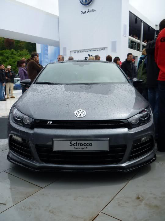

                      Now that Carbon front lip on the Scirocco X should be standard... Just saying is all 😉
                      Candy White Scirocco R DSG with Panoramic Sunroof and RNS510 Sat Nav, tint
                      Cup Rear Spoiler, VMR V718 GM rims, APR Tuned, Brembo 6 pot BBK, Eibach Pro-Kit springs, Low line RVC, Exhaust flap delete
                        Originally posted by Andych View Post
                        Now that Carbon front lip on the Scirocco X should be standard... Just saying is all ��
                        Which would add another 2cm to an already low front end.
                        Standard lowering springs already take it to 12cm off the ground, so a lip would almost certainly take it into illegal territory.
