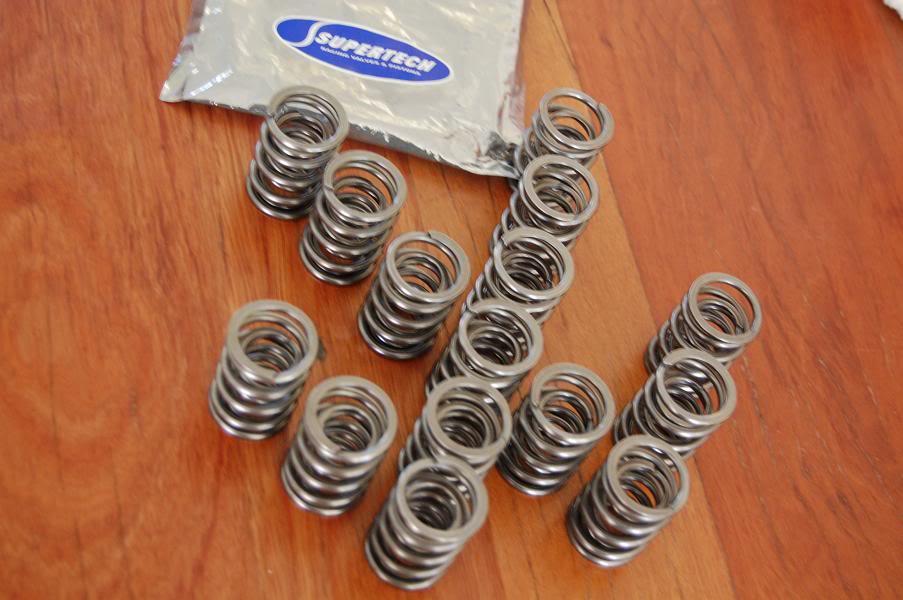

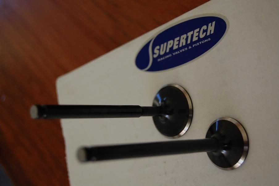

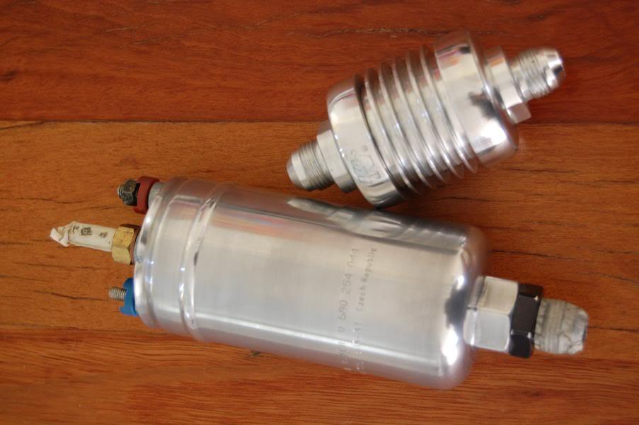

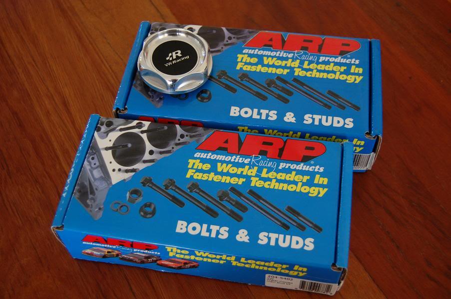

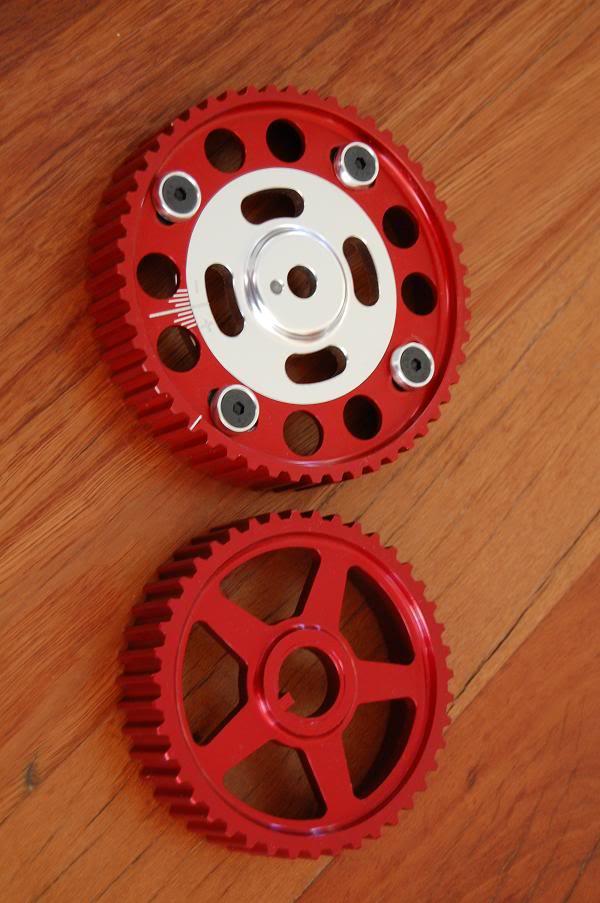

              A little engine eye candy!
              Techtonics Tuning cam gear and Autotech itermediate gear
              Supertech valve springs
              Bosche 044 pump and K & N fuel filter
              ARP bolts and polished oil filler cap
              Supertech oversize inlet and exhaust valves

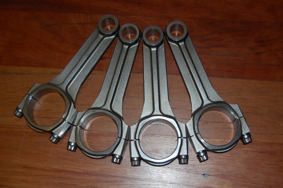

                      Heres a pic of the Pauter '' X'' beam connecting rods for my rocco. Far better than the cheap "H'' beam chinese ones available...
