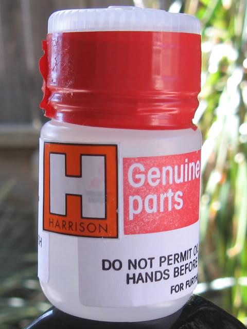

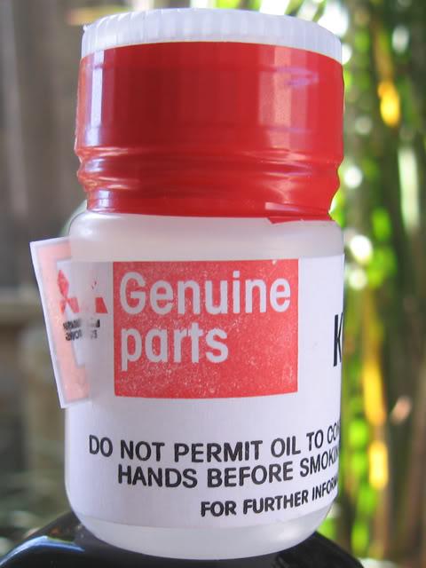

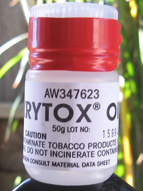

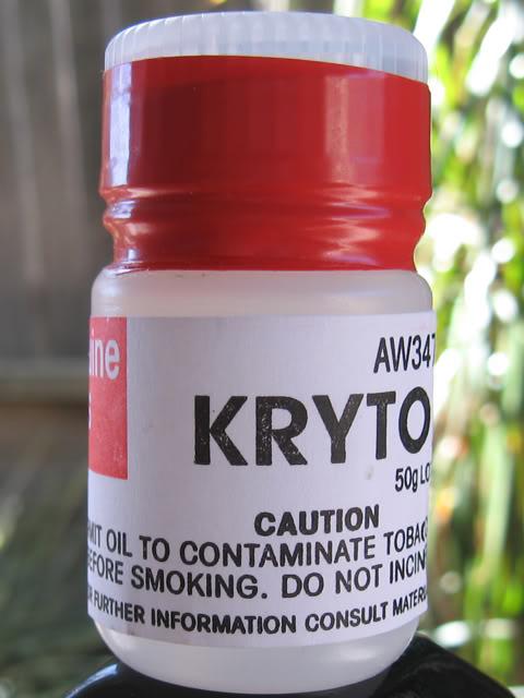

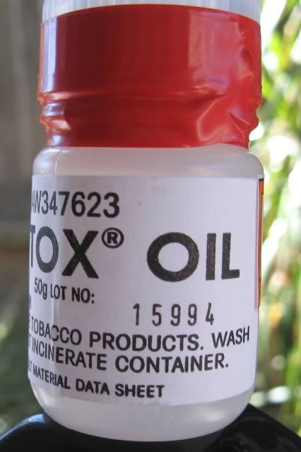

                You are correct about the ex-factory container size - Harrisons are an official DuPont distributor and started decanting from this container into 50ml bottles for Mitsubishi Australia and supplied these with a Mitsubishi part number. Due to the demand from personal shoppers following recommendations on various car enthusiast forums for GMH, Ford and other makes, they will supply Krytox Oil with a minimum order of 2 x 50ml bottles.
                My bottles are branded Krytox Oil AW347623 with a lot number - the Mitsubishi logo on the Mitsubishi Genuine Parts is covered by a "Harrison" sticker. The following photos show the container:
                Note Mitsubishi logo under sticker
