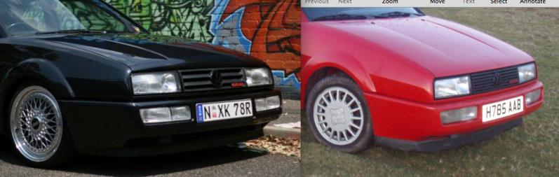

    Yep pretty much mate, VR's had a wider rear beam, same as Golf VR Mk3 set up at the front, wider by 10mm. G60 standard wheels were ET33 and standard VR were ET43, so the centre line is shifted out but the outside of the rim is in the same place.
    Bodies are slightly different depending on age, the early 4 cyl Corrados had a bonnet like this -_- and the VR's were like this _-_ (buldge in the middle), and the front guards were slightly wider. Early 4 cyl and early VR6 had slightly different bumpers, the swage line is different and the fogs and indicators are more set back. Pre '92 also had more slats in the front grill. Early (pre '92 except G60's) had different dashboards too. The heater controls are all dials rather than sliders, they moved the electric window switches. Have a look at some pics on the-corrado.net you'll see what i mean. I think that's about it.

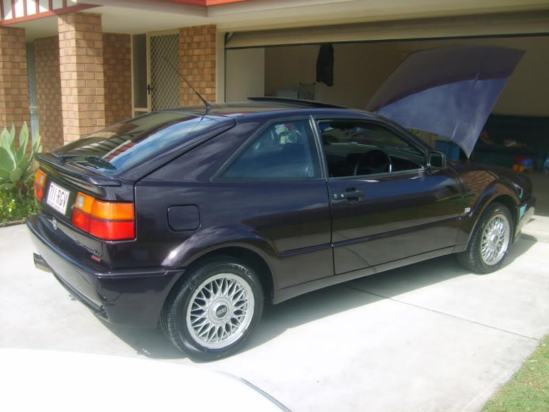

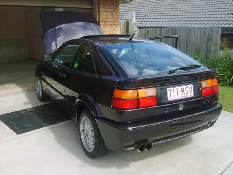

                            Early vs late, i thought Jonny's was a '92, but his bumper is an early one. Haven't got a pic of the front of it.
                            Not the best photos but if you can zoom in you'll see the differences more clearly..
                            ---------- Post added at 12:17 PM ---------- Previous post was at 12:09 PM ----------
                            Actually, i did have a pic of Jonny's, looks like a late bonnet to me;
                              Grrrr. It does look like a late one. Does look in good condition. Why can't they all be VR6's!!!!
