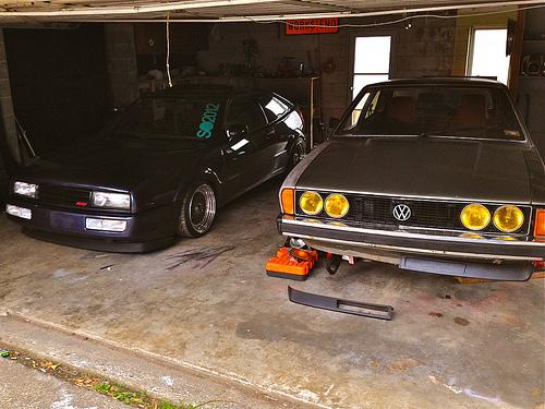

    Rocco is looking like this at the moment - currently converting the front wings & lights to pre facelift. I got an engine stand today to so i'll start cleaning up the KR 16v (ex rado) for use in the mk1. Over the winter I want to make the motor show spec, super polished & painted and want to run a carb setup of some sort.

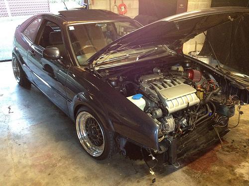

                    So the 24v motor seized over the weekend so it's coming out this week. No idea how/why it seized yet until we open it up, but it's time to get on with it and get it running again. On the look out for a Mk4 R32 motor if anyone has one.

                                Old motor seized because it obviously bottomed out (I know when it happened now) but I didn't feel it touch at all. Sump kissed the ground when I was going a bit quick. The sump smashed the oil pick up into pieces so when I dropped the sump I found a chunk of it sitting there.
                                R32 motor is in now:
