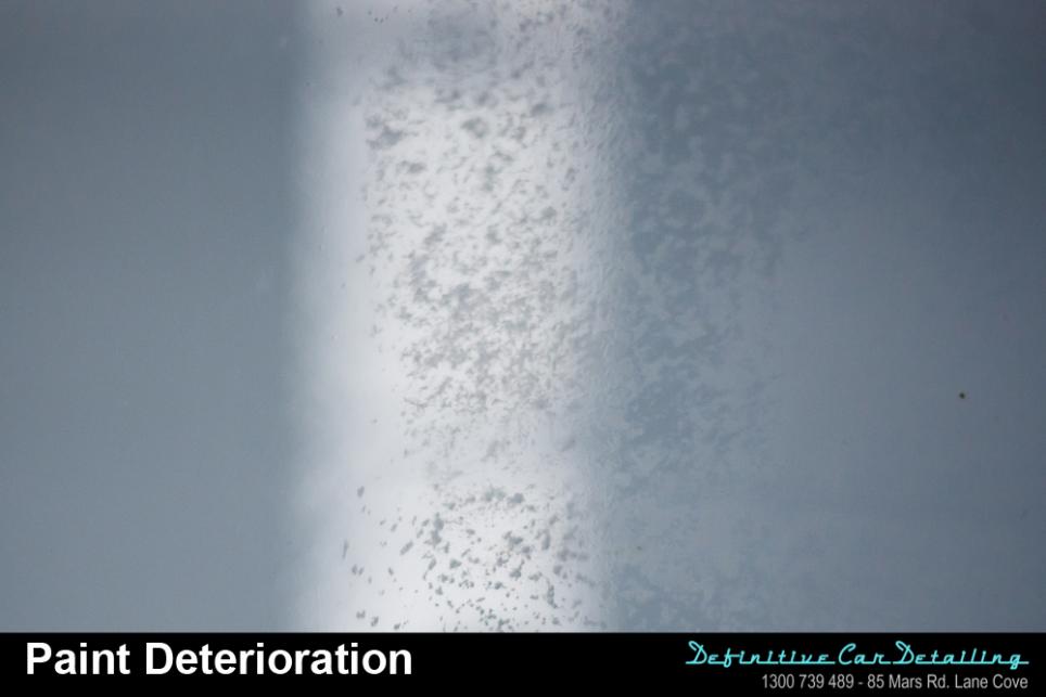

Single Stage paint means there is no clearcoat, the paint surface is much more porous & prone to degradation if neglected.
As you can see in the before photo, the paint was covered in alot of nasty contaminants, resulting in a cloudy haze covering the entire car.
Paint Correction done by Zentool, Rupes Green Pad, Optimum Hyper Polish. Finally had a chance to put my Grit Guard Pad Washer to full use!
